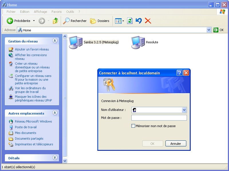

I see meteohub in my home network
But i can,'t reach the directory because my user name (meteohub) and my password does not work ???
I am on Windows XP
Posts: 8033
Re: How to go in the directory of Meteohub
password is always "meteohub", regardless your web interface password. Manual also says so.

sometimes it doesn´t work with the graphical interface, because Windows by default attempts to use the windows username.
But it always works from cmd
Open a command line and enter
net use * \\192.168.1.77\public /user:meteohub
* means, the drive is mapped to the next free drive letter available
if you want a particular letter assigned to the remote drive, replace * with a free letter
This line will map meteohub drive to M:
net use M: \\192.168.1.77\public /user:meteohub
in both cases you need to enter the password manually when prompted.
But you can also create a link on your desktop and put the password into the line
be aware that in that case this machine should only be used by you and/or secured with a user password
%windir%\system32\net.exe use M: \\192.168.1.77\public password /user:meteohub

Thank you so much !
