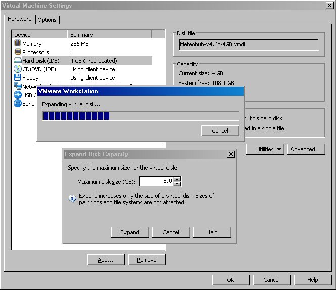

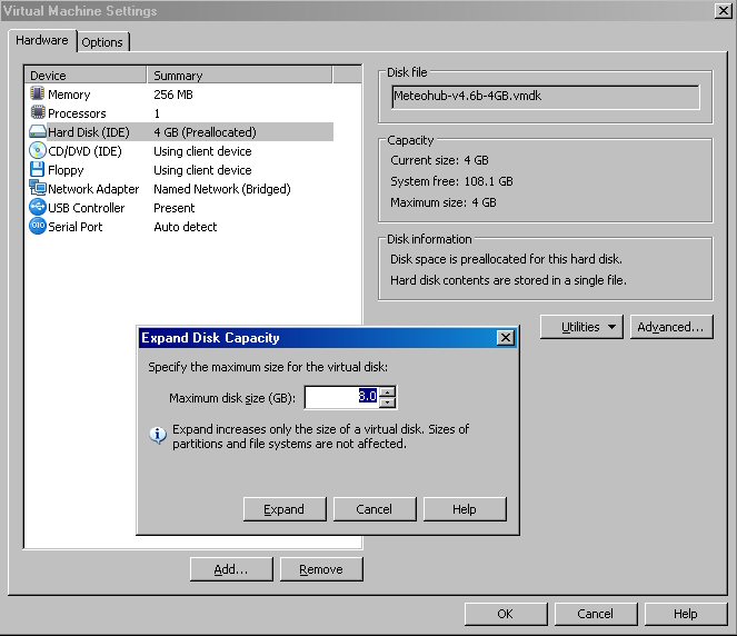

I found how to expand the pre allocated disk size for VMware, it's 10GB now but the message I've got was that I have to repartition the guest operating system.
I hope your notes can tell me how to do that

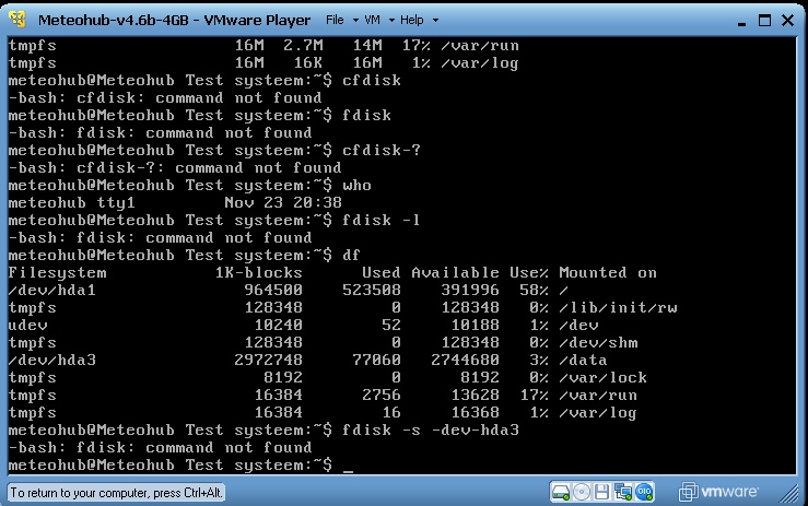

Thanks for the info but it looks like if the fdisk command is not implemented in VMware image.
All the fdisk commands are replied with -bash fdisk: command not found

Are you logged in as root?
Normally the root prompt is #, while a regular user is identified with a $ prompt.
type "id" to find out

OK, logged in as root, this is what I get
- VMware.jpg (116.94 KiB) Viewed 13720 times

00 ) Physical setup
--- For VMWare, simply grow the virtual disk in the vmware configuration: -- For other systems, just get a bigger memory card/stick, configure meteohub on the smaller stick, and then grow

Thats wat I call a work around!! Beuatifull, thanks, I have something to do this evening!
Starting some time earlier but stuck after the first command...
- MH01.jpg (19.15 KiB) Viewed 13701 times

Looks a typo:
S20loggerd is the file you are going to change drop the '1" in the middle.
Probably best to use cut 'n paste as much as possible to prevent typo's

You're right, I see the mistake ...
I can go on with this exercise over 2 weeks because I have to go abroad for 2 weeks for work, hopeful I can find a good internet connection so I can use VNC to do something else I have to wait until I'm back home.
