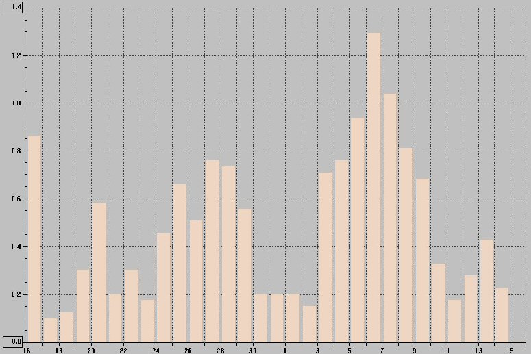

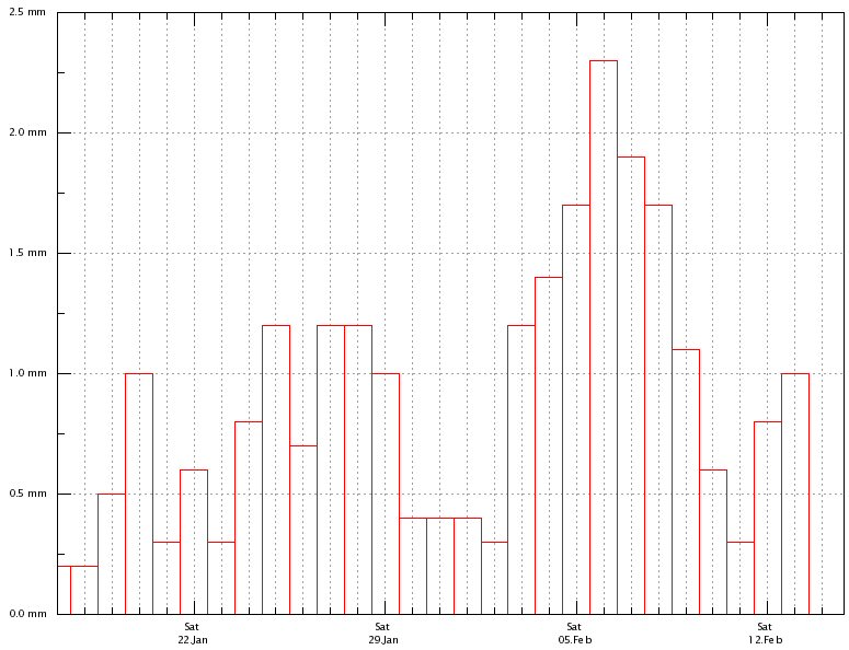

I agree, I see the same over here:
ET Graph according to MH
ETH Graph according to WeatherLink
To help debugging this I've created a table, its shows
- Date in yyyymmdd<timestamp of last recording>
- Raw value as seen in the raw data file
- Converted from Inches to CM (The Davis loop reports in fractions of an inch)
- Value seen on the Davis Console
As one can see the Davis Console seems to do some odd rounding.
