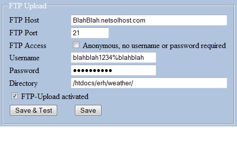

I've set up FTP transfers as documented, and the upload test succeeds (meteohub-upload.test file shows up in the desired location when pressing save&test).

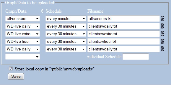

I've set up to upload graphs as shown:
meteohub graph upload.jpg (56.44 KiB) Viewed 8220 times
These files never show up in the destination location. I have logged into meteohub using SSH and the files in the uploads directory seem to have correct permissions (RW for owner, R for everybody else) and I did a manual FTP of the files to the web site. Again, the test file does successfully transfer to the web site.

I got some hints from viewtopic.php?f=8&t=8086&p=8456&hilit=cron#p8456
Looking at crontab -l I see the following (full output at bottom of post):
cp /var/run/meteohub/clientrawdaily.out /var/run/meteohub/perm/clientrawdaily.txt; mv /var/run/meteohub/clientrawdaily.out "/var/run/meteohub/uploads/clientrawdaily.txt"
*/1 * * * *     sleep 20; [ -z "`ls /var/run/meteohub/uploads/`" ] || [ -n "`/bin/pidof /usr/bin/ncftpput`" ] || /usr/bin/ncftpput -S .tmp -R -V -DD -u "blah123456%12345a9" -p "Blahefg9hi" -P 21 01234a9.netsolhost.com /htdocs/destination/weather/ /var/run/meteohub/uploads/* 2>&1 | /usr/bin/logger
Following the instructions in the aforementioned post:
has the following files in it (they appear current): allsensors.txt clientrawdaily.txt clientrawextra.txt clientrawhour.txt
yields no output, so no ncftpput processing running
Any ideas why the ftp isn't transferring files, and how to get it working again?
Ed
Full crontab -l follows...
*/1 */1 * * *   /bin/pidof -x histeval0 || /usr/bin/nice /home/meteohub/histeval0
*/5 */1 * * *   /bin/pidof -x histeval1 || /usr/bin/nice /home/meteohub/histeval1
13 */6 * * *   /bin/pidof -x histeval2 || /usr/bin/nice /home/meteohub/histeval2
47 4 * * *   /bin/pidof -x histeval3 || /usr/bin/nice /home/meteohub/histeval3
*/1 * * * * /bin/cat /proc/uptime >/var/run/meteohub/alive
22,52 * * * * echo 'wdnow' >/dev/meteohub
17 */6 * * * rm /var/run/*.idx
*/1 * * * * ([ -n "`/bin/pidof thttpd`" ] && [ -n "`/bin/pidof thttpdbackup`" ]) || rcthttpd restart
26 6 * * * nice /srv/www/meteolog.cgi 0 0
37 2 * * * /usr/bin/test -f /home/meteohub/autoreboot && echo norecompute >/home/meteohub/norecompute && /sbin/shutdown -r -n now
# generate history data
# synchronize hw clock
44 */2 * * * /sbin/hwclock -w
# compute weather data
8,18,28,38,48,58 * * * * /usr/bin/nice /home/meteohub/wmr928eval -x -c min1 -t -3600 -w /data/weather/ -s /home/meteohub/wmr928eval.conf -e /home/meteohub/wswin.conf -E /home/meteohub/wd.conf
1,11,21,31,41,51  * * * * /usr/bin/nice /home/meteohub/wmr928eval -c min5 -t -3600 -w /data/weather/ -s /home/meteohub/wmr928eval.conf
2,22,42 * * * * /usr/bin/nice /home/meteohub/wmr928eval -c min10 -t -3600 -w /data/weather/ -s /home/meteohub/wmr928eval.conf
3,33 * * * * /usr/bin/nice /home/meteohub/wmr928eval -c min30 -t -7200 -w /data/weather/ -s /home/meteohub/wmr928eval.conf
3 * * * * /usr/bin/nice /home/meteohub/wmr928eval -c hour1 -t -7200 -w /data/weather/ -s /home/meteohub/wmr928eval.conf
4 0,6,12,18 * * * /usr/bin/nice /home/meteohub/wmr928eval -c hour6 -t -50000 -w /data/weather/ -s /home/meteohub/wmr928eval.conf
5 2 * * * /usr/bin/nice /home/meteohub/wmr928eval -c day1 -t -200000 -w /data/weather/ -s /home/meteohub/wmr928eval.conf
6 2 1 * * /usr/bin/nice /home/meteohub/wmr928eval -c month1 -t -7000000 -w /data/weather/ -s /home/meteohub/wmr928eval.conf
# test for complete recomputation of weather data
*/5 * * * * /home/meteohub/wmr928fullevalwrapper >/dev/null 2>>/data/log/messages
# cut wswin import data into monthly chunks
*/3 * * * * /bin/pidof wswinimport || /usr/bin/nice /home/meteohub/wswinimport 2>>/data/log/messages
# check for alarms to be mailed to the admin and send them once a day
44 5,11,17,23 * * * /home/meteohub/alarm check "" >/dev/null 2>>/data/log/messages
55 23 * * * /home/meteohub/alarm send "" >/dev/null 2>>/data/log/messages
# shorten logfiles
12 0 * * * /usr/bin/tail -n 1000 /data/log/thttpd.log >/data/log/thttpd.log.new; /bin/mv -f /data/log/thttpd.log.new /data/log/thttpd.log
13 0 * * * /usr/bin/tail -n 1000 /data/log/ntp.log >/data/log/ntp.log.new; /bin/mv -f /data/log/ntp.log.new /data/log/ntp.log
14 0 * * * /usr/bin/tail -n 1000 /data/log/smb.log >/data/log/smb.log.new; /bin/mv -f /data/log/smb.log.new /data/log/smb.log
15 0 * * * /usr/bin/tail -n 1000 /data/log/meteohub.log >/data/log/meteohub.log.new; /bin/mv -f /data/log/meteohub.log.new /data/log/meteohub.log
16 0 * * * /usr/bin/tail -n 1000 /data/log/alarm.log >/data/log/alarm.log.new; /bin/mv -f /data/log/alarm.log.new /data/log/alarm.log
17 */6 * * * /usr/bin/tail -n 1000 /var/cron/log >/var/cron/log.new; /bin/mv -f /var/cron/log.new /var/cron/log
## start section written by meteohub
0 0 1 * * /bin/echo "norecompute" >/home/meteohub/norecompute && /sbin/shutdown -r now
*/5 * * * *     sleep 120; /home/meteohub/meteonet
#- "all-sensors" "*/1 * * * *" "allsensors.txt" 0
*/1 * * * *     sleep 0; /srv/www/meteograph.cgi text all>/var/run/meteohub/all-sensors0.txt; /srv/www/cgi-bin/stamp.cgi cp "/var/run/meteohub/all-sensors0.txt" "/var/run/meteohub/perm/allsensors.txt"; /srv/www/cgi-bin/stamp.cgi cp "/var/run/meteohub/all-sensors0.txt" "/data/myweb/uploads/allsensors.txt"; /srv/www/cgi-bin/stamp.cgi mv "/var/run/meteohub/all-sensors0.txt" "/var/run/meteohub/uploads/allsensors.txt"
#- "WD-live daily" "*/30 * * * *" "clientrawdaily.txt" 0
*/30 * * * *    sleep 0; /srv/www/meteohtml.cgi /home/meteohub/clientrawdaily.conf >/var/run/meteohub/clientrawdaily.out; cp /var/run/meteohub/clientrawdaily.out /data/myweb/uploads/clientrawdaily.txt; cp /var/run/meteohub/clientrawdaily.out /var/run/meteohub/perm/clientrawdaily.txt; mv /var/run/meteohub/clientrawdaily.out "/var/run/meteohub/uploads/clientrawdaily.txt"
#- "WD-live extra" "*/30 * * * *" "clientrawextra.txt" 0
*/30 * * * *    sleep 4; /srv/www/meteohtml.cgi /home/meteohub/clientrawextra.conf >/var/run/meteohub/clientrawextra.out; cp /var/run/meteohub/clientrawextra.out /data/myweb/uploads/clientrawextra.txt; cp /var/run/meteohub/clientrawextra.out /var/run/meteohub/perm/clientrawextra.txt; mv /var/run/meteohub/clientrawextra.out "/var/run/meteohub/uploads/clientrawextra.txt"
#- "WD-live hour" "*/30 * * * *" "clientrawhour.txt" 0
*/30 * * * *    sleep 8; /srv/www/meteohtml.cgi /home/meteohub/clientrawhour.conf >/var/run/meteohub/clientrawhour.out; cp /var/run/meteohub/clientrawhour.out /data/myweb/uploads/clientrawhour.txt; cp /var/run/meteohub/clientrawhour.out /var/run/meteohub/perm/clientrawhour.txt; mv /var/run/meteohub/clientrawhour.out "/var/run/meteohub/uploads/clientrawhour.txt"
*/30 * * * *    sleep 12; /srv/www/meteohtml.cgi /home/meteohub/clientrawdaily.conf >/var/run/meteohub/clientrawdaily.out; cp /var/run/meteohub/clientrawdaily.out /data/myweb/uploads/clientrawdaily.txt; cp /var/run/meteohub/clientrawdaily.out /var/run/meteohub/perm/clientrawdaily.txt; mv /var/run/meteohub/clientrawdaily.out "/var/run/meteohub/uploads/clientrawdaily.txt"
## end section written by meteohub

I've had the same problem. Check your password or login. i've set password with % and it's generated an error.
EdBeavWX
Posts: 14
Joined: Fri Feb 18, 2011 10:05 pm
Re: Scheduled FTP transfer fails, but upload test succeeds
Post by EdBeavWX »
pucek wrote:I've had the same problem. Check your password or login. i've set password with % and it's generated an error.
Three questions:
Does the upload test succeed for you?
Are you saying you are having problems with passwords that contain the percent character?
What error are you getting? Mine simply fails to upload with no error.
Ed
Manhart
Posts: 63
Joined: Wed Sep 03, 2008 11:41 am
Location: 8312 Winterberg - Switzerland
Post by Manhart »
The password must be without %. I had to change my password because of this character. The test worked, but i never saw a file uploaded.
Matthias
