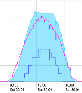

skyewright wrote:As YJB says, a UV sensor isn't suitable for that (plus the fact that the OS sensor only reports to integer resolution means it would not be very good for the purpose even if UV was a useful measure in this case).
You'd probably find a "temp in a jar" style solar sensor more useful (the OS temp only 'on a lead' sensors are good for that purpose).
To illustrate this I've attached an image showing solar (the red line), UV (the blue line) and "temp in a jar" (pale blue shaded area) for yesterday.
The "temp in a jar" is actually plotting the difference in temperature between the normal outdoor temp sensor and the temperature inside the "jar".
I've not included the scales, it's the relative shapes of the plots that are of interest rather than the figures measured.

skyewright wrote:You'd probably find a "temp in a jar" style solar sensor more useful
Just to get that straight:
What you're telling is, that the difference of the regular outdoor temp and a sensor put in a glass will be a very cheap and accurate alternative to expensive and not always accurate solar sensors? And in addition it also seems to be a way for an UV sensor to be connected to the WMR928! :shock:
skyewright wrote:I've not included the scales, it's the relative shapes of the plots that are of interest rather than the figures measured.
Do you have any idea what that means in terms of UV index or solar power? I've to confess that I'm far away from havin' a clue on solar energy measurement.
Cheap: yes
Useful: yes
Accurate: No. Just a useful indication, provided you keep an eye on and regularly adjust the temp difference that equates to "noon clear sky".
WeatherDisplay users can get an estimate of W/m2 from a temp in a jar sensor but the figure is very much an estimate rather than a measure.
I'm not sure where you get the impression that the expensive solar sensors are not accurate.
