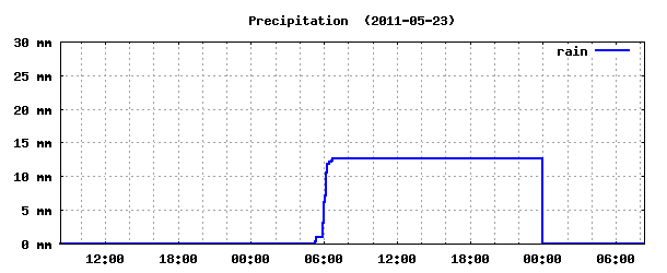

We had some rain today, so far it's looking good, now only wait until the midnight reset.
pinto
Posts: 25
Joined: Thu Apr 14, 2011 7:33 pm
Re: cumulative raingraph with gnuplot
Post by pinto »
And last 48 hours, midnight reset is working.
