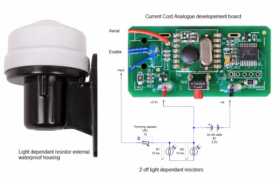

I have been experimenting with a solar sensor made up of a Current Cost energy monitor analogue Development Board. The board has a couple of light dependant resistors added and a variable resistor.
The light dependant resistors are mounted in an old automatic light sensor box which is then clipped onto my wind mount sensor pole. They are then cabled down to my current cost board. Readings are then fed into my Current cost CC128 that is plugged into my meteohub as a 2nd weather station.
Using the preset I have set full sunlight to show as 21.9kWatt on my CC128. Meteohub sees this as a value of 21984.
The sensor are very sensitive and the "full sun" value drops even if a very very fine wispy cloud moves over the sun.
Using meteoplug I apply a multiplication factor of 0.00455 in the graph definitions to show a relative value of 100 for full sun.

Solar sensor diagram
