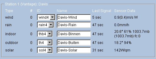

So I hooked up a vantage pro to the usb and I get most of the data fine. the issue seems to be that Humidity is not seen? On the sensor screen its not listed. Also which temp sensor is indoor and which one is outdoor?

Humidity is not a distinct sensor; it's a seconday field of the temperature sensor.
Indoor and outdoor sensors are clearly maked, you will just need to map those in Meteohub.
Below a screenshot of what I've got:

Post by danswatman »
thanks I was able to correct my errors using the information you supplied :) Understanding that Humidity and apparently pressure are sub fields of the temp made the case ...
