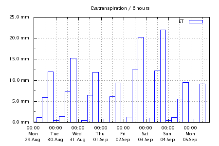

(While looking at this, keep in mind that the Vantage only runs the ET calculation on top of each hour for the preceding hour, so the value for ET will remain unchanged for the duration of the entire hour.)
Look at this:
The hourly interval shows results that are at least in sync with my MH numbers:
Now let's change the report to 6 hours, still ok:

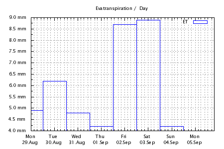

But looking at the daily values something goes wrong:
As one can see the daily values are only a fraction of the numbers reported (when comparing with 6 hour or 1 hour interval).
