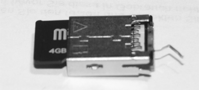

As the reliability of the DeLock Nano does varry that much, I decided to open my failed one... and surprise,
IT IS NOT A USB STICK, but a microSD card reader! The mircoSD card is fitted into the connecting side of the USB connector :roll:
This also explains why this "stick" does report in Linux like this:
   Host scsi89: usb-storage
       Vendor: Silicon Motion, Inc.
      Product: Generic USB2.0 card
Serial Number: 12345678901234567890
     Protocol: Transparent SCSI
    Transport: Bulk
Knowing that, it is very obvious, that the quality of the "stick" does depend on the quality of the used microSD card and DeLock does for sure source that differently between lots. As a result, I can no longer recommend that stick as long as you don't have a decent mircoSD card to swap in instead of the one that comes along with the "stick" ;-)

While experimenting with different USB drives and micro SD cards (with the main goal of trying to find a low profile USB stick or card adapter that works well with the Iconnect/Meteohub system), I was frustrated by several failures to get micro SD cards to boot properly, even though they imaged correctly. I initially attributed my microSD card failures to simply being "new" to the Meteohub / Linux process and not understanding the correct way to image them. Now I am of the opinion that not all card adapters work identically or not all microSD cards work well.
Boris, your photo of the Delock Nano made remember that I purchased a very inexpesive microSD card adapter when I first started off and it looks very much like your Delock Nano. In this particular card adapter, I tried to run a SanDisk 4gb, class 2 micro SD card (it was what I had in my junk box) and having that fail to boot even though it imaged correctly, I went out and purchased a Patriot 8gb class 10 card microSD card ...it too imaged correctly but failed to boot. Having an old 4gb USB stick SanDisk Cruzer laying about, I imaged it and tried it in an effort to troubleshoot what was going on...lo and behold, it worked and booted. I never thought much more about the microSD cards until seeing your photo above.
So, its interesting that your Delock Nano is nothing more than a card adapter with a microSD card in it. This means not all microSD cards are the same and that even expensive class 10 cards from reputable manufacturers can have boot issues. It could also mean different quality card adapters would work with these particular microSD cards... something Ill have to experiment with sometime. Could it be that a proper card reader would work with these microSD cards where this inexpesive microSD card adapter would not? More experiments to do! :)

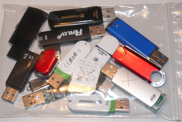

This is my boneyard of destroyed sticks... Better I do not sum up the expense ;-)
If someone is interested to run the same test program on his Linux system to destroy some of his sample sticks, I can drop the code (very basic code without bells and whistles) to make these results comparable to my findings.
