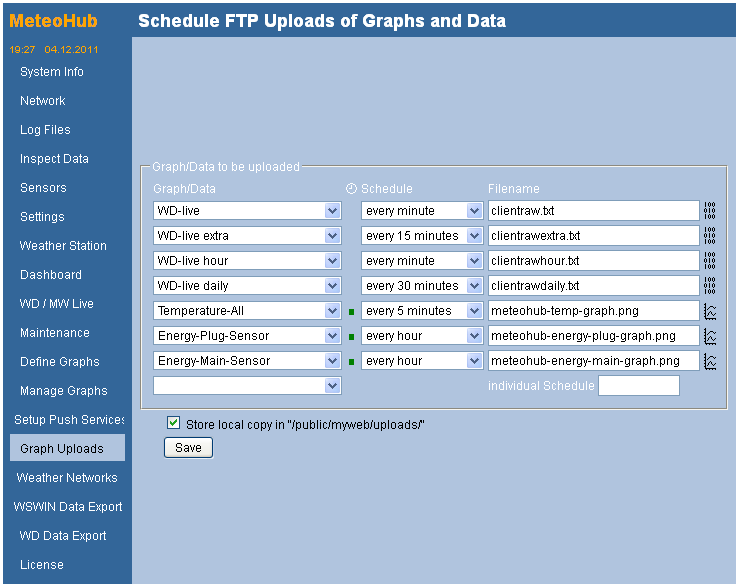

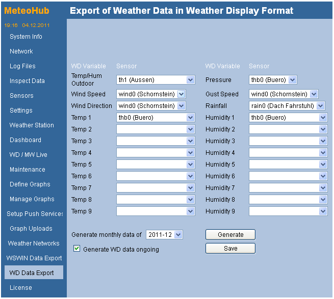

Today I tried to make use of http://sietse.net/iwdl-info/. From what I understand this has been tested and operated by many meteohub users already. I cannot make it run (see yourself http://www.dieferbers.de/meteohub/iwdl/#home) due the the fact that my http://www.dieferbers.de/meteohub/clientraw.txt looks incomplete. If I copy someone else clientraw.txt to my folder iwdl is fine. So the problem must be the generating of the clientraw.txt file. Here is my setting in "WD data export"
and the "Graph Upload"
So what do I do wrong here?

your mistake >>> you selected the wrong menu!!
for the clientraw-files to be created you have to select another menu:
WD / MW LIVE
You must select your sensors there and your clientraw files will be uploaded with updated data ...

Now I found my bug. There is another tab called "WD / MW Live" = "WD Live" and "Meteoware Live" Support. Only if you set this up the WD data is generated for FTP. The "data export" generate only files in /export.
