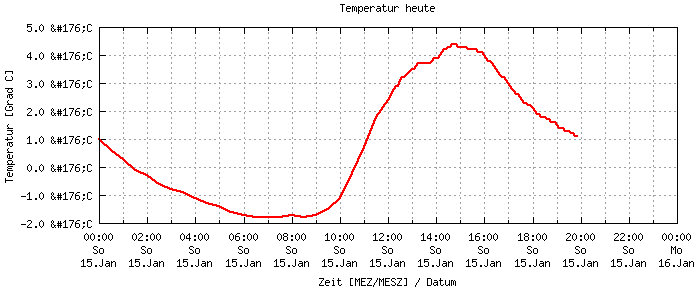

Hello everyone,
i'm drawing first graphs with Meteohub. With the definition "set term png small" i could change the font style and the put the whole graph near the y-axis label. However, now the °-character disappeared and the html-code is written instead (see attached image).
Is there a possibility to write only the values on the y-axis, without the unit (°C)? The unit become also unnecessary with the labeling of the axis.
Thanks for any reply,
Christian
Posts: 8033
Re: Graphs: y-values without unit?
yes, you can handle that by using a gnuplot comand in the graph definition "format cmd" field. Please search for "gnuplot format" in the forum.

Ok, thanks, problem solved.
