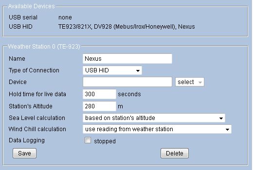

Secondary
At the station settings, the Nexus is visible for Meteohub but I cant select it (Device is not selectable)... I assume that this is producing the sensors problem...
Re: Sennsors error
your settings are fine. device field is just needed for serial and usb serial connections, not usb hid.
Try to place the station differently. Is the console displaying recent data?
