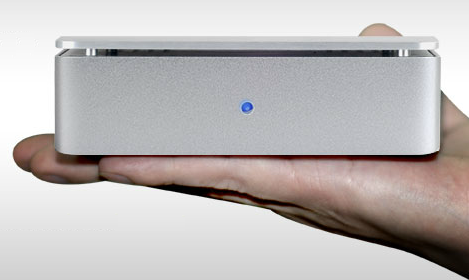

Meteohub port to Silverstone DC01 (also branded as AKiTiO MyCloud Mini) is close to being finished. This is another ARM platform like SheevaPlug/iConnect but not based on Marvell Kirkwood chipset but on PLX SOCs not so well supported by the ARM community. Fiddling around with these a bit I could manage to compile kernels and modules for Linux 2.6.31 for it and putting a Debian Squeeze on top of this. I also got some control of the LED so that the unit can signal it's IP in the Meteohub blinking style. Press of reset button can also be detected (although Meteohub does not make use of it right now).
The unit is dressed in a charming small Metal case (black or silver at your choice) that can hold a 2.5" SATA drive internally. And that makes the DC01 so attractive from my point of view. Forget about SD cards and USB sticks. Just put in a small, cheap SSD and get rid of the external storage media hassle. I did with a OCZ vertex for 40 Euro and read/write speeds are way ahead of what USB sticks and SD cards can provide and also wear leveling is at a much much better level, as these SSDs are designed to run as root file system.
Connectivity is OK with the DC01. You have 2 USB 2.0 ports, ethernet, e-SATA (not used by Meteohub). Compared to the still very attractive iConnect which unfortunately just dropped out of production (EOL since beginning of 2012) the DC01 is lacking WLAN and does have 2 instead of 4 USB ports to be used for devices.
