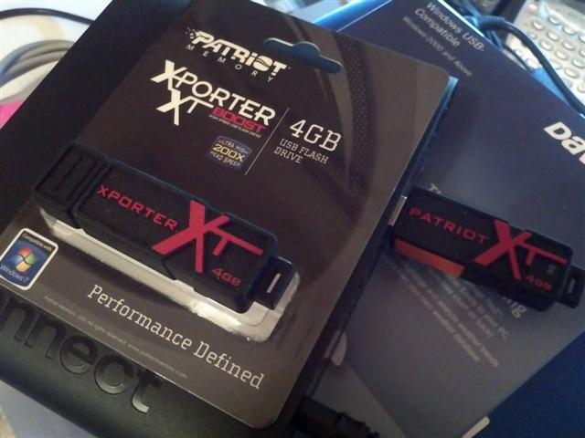

Patriot Xporter XT Boost 4GB works extremly reliable here. Are you sure you are using this one:
AlaskaWX
Posts: 36
Joined: Thu Apr 05, 2012 7:46 pm
Re: iConnect and Patroit XT 4GB USB Stick Cold Boot Problems
Post by AlaskaWX »
Yes, they look indentical to the ones you are using...

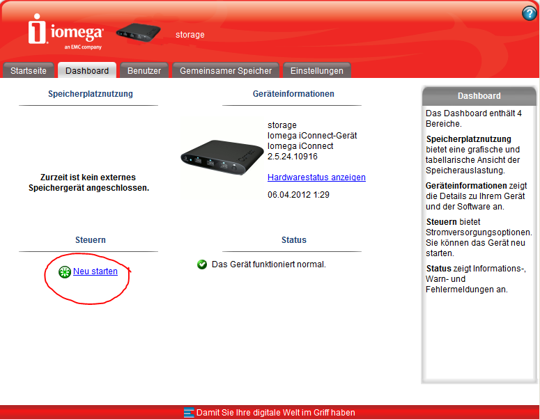

iConnect in regular operation as designed by iomega, do click through inital setup until you can reach
the "dashboard". There you will find a "restart" function as circled in red below.
Plug prepared Meteohub USB stick into the iConnect and press restart link (marked red on the
picture above). During restart keep reset button pressed with a paper clip until LED turns red and proceed as described
in the Meteohub iConnect installation instructions.
