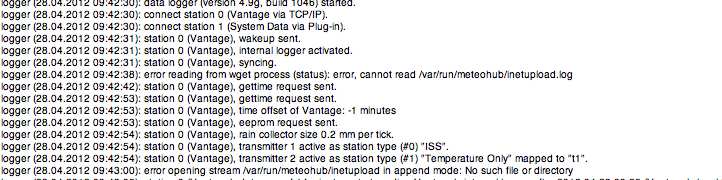

Found a new error today which showed up for the first time (at least i noticed these error) after last update 4.9g.
When starting the logger:
>> logger (28.04.2012 09:19:01): error reading from wget process (status): error, cannot read /var/run/meteohub/inetupload.log
then continuous:
>> logger (28.04.2012 09:19:05): error opening stream /var/run/meteohub/inetupload in append mode: No such file or directory
Using SSH-FTP (Cyberduck for the mac) i saw that there is indeed no meteohub/ folder inside /var/run/.
So there is no /var/run/uploads either in the DC01 file structure. These folders are there in VMWARE and Alix version and contain the files to be uploaded.
Are these 'missing' folders maybe the reason for the fail of the FTP uploads or has the DC01 just a different file-structure?
The /data/uploads/ shortcut is present and funtional in VMWARE and Alix.
It is a "invalid link" in DC01.
Hope this will somehow help to solve the NO-FTP issue.

Re: DC01 NEW box,disc,latest release: NO FTP and more errors
Looks like a good finding. Will check with the DC01 distribution of Meteohub. Folder setup should be identical with all the Meteohubs, but when building a new platform things can be omitted by accident.

Some more erros: Maybe it gives a clue:
Other strange errors (for a non Linux user), these on from system log:
-04-25T12:10:50.686137+02:00 meteohub rsyslogd: Warning: backward compatibility layer added to following directive to rsyslog.conf: ModLoad imuxsock
cat: /data/weather/20*/raw: No such file or directory
expr: division by zero
2012-04-25T19:08:42.389047+02:00 meteohub rsyslogd: WARNING: rsyslogd is running in compatibility mode. Automatically generated config directives may interfer with your rsyslog.conf settings. We suggest upgrading your config and adding -c4 as the first rsyslogd option.
==== last error goes on until today (division by zero only in april with old meteohub release)
2012-05-04T15:33:38.189214+02:00 meteohub rsyslogd: WARNING: rsyslogd is running in compatibility mode. Automatically generated config directives may interfer with your rsyslog.conf settings. We suggest upgrading your config and adding -c4 as the first rsyslogd option.
2012-05-04T15:33:38.198609+02:00 meteohub rsyslogd: Warning: backward compatibility layer added to following directive to rsyslog.conf: ModLoad immark
2012-05-04T15:33:38.206698+02:00 meteohub rsyslogd: Warning: backward compatibility layer added to following directive to rsyslog.conf: MarkMessagePeriod 1200
2012-05-04T15:33:38.206778+02:00 meteohub rsyslogd: Warning: backward compatibility layer added to following directive to rsyslog.conf: ModLoad imuxsock
