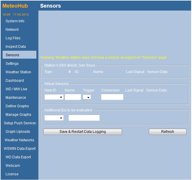

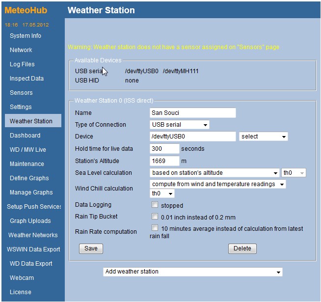

can you please provide a screen dump of "weather station" and "sensors" pages?

I've attached jpg screen captures.

ISS direct needs the ISS direct connect kit from smartbedded. I guess you have a regular Vantage data logger. So please delete this station setting an select "Vantage" as station type.
