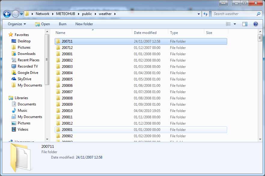

I backup Meteohub every night using cwrsync. I also run Syncback every now and then from my Windows PC to backup to my Stora Network drive.
Just to check before I delete some of my data.
See attachment from Windows 7.
Can I just right click on the folder and select delete?
Then goto Meteohub and under "Maintenance" and select "Recompute" or do I have to Stop Data logging first?
In the future if I get a larger card I presume I can just copy the folder back in from my backup and do another recompute?

I like to keep an extra "raw" (i.e. uncompessed & readable) archive too. "Belt & Braces" (I hope).oliverb wrote:I backup Meteohub every night using cwrsync. I also run Syncback every now and then from my Windows PC to backup to my Stora Network drive.
I think that in theory stopping Data Logging might be "A Good Idea", but I figure that the files that are being deleted are not actively being added to so for several years I haven't bother to do that while doing my annual prune, and I've not seen any problem with that approach.oliverb wrote:See attachment from Windows 7.
That's the general idea I have in mind.oliverb wrote:In the future if I get a larger card I presume I can just copy the folder back in from my backup and do another recompute?
However if you were adding a larger card to the alix-1d I think you'd also need some work (repartitioning?) to make the extra space accesssible to Meteohub first?

Thanks again for your help.
I have deleted the two months from 2007. This should buy me some time while I decide if I am going to get a larger flash card or just run with a few years data on Meteohub and use Meteoplug for my main data source.
