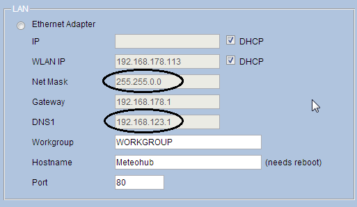

But there is a Problem with the DHCP configuration over the WLAN. Some network parameters are wrong:
It seems the Meteohub on the Mini X got a Class B Netmask but there is a Class C Netmask configured on the Router. Just as the DNS Server IP and the Gateway IP are configured with the same address and not with the address shown in Network Configuration for DNS1. Other devices in my WLAN got the right parameters

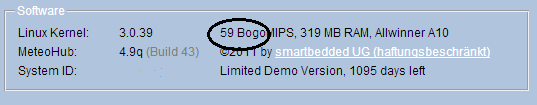

I don't believe this bogos are right.

Thanks for pointing out the mask and dns issue. I will fix that shortly.
In the meantime, please switch to non-dhcp and set data manually,
press save and reboot.
bogomips should not bother you. A10 SOC is dynamically clocked. So when idle,
performance goes down, when busy it will go up to the 1000 bogomips you do expect.
This is done to keep power consumption as low as possible.
Re: Mini X - a new member in the family
please give the new image a try, it should have this fixed.

With the v2 Image installed the Mini X can't connect to the WLAN (SSID=meteohub). So I did the setup in headed variant.
After setting the SSID and pass phrase per keyboard the Mini X connected without problems. The DHCP works well all parameters got the expected values.
