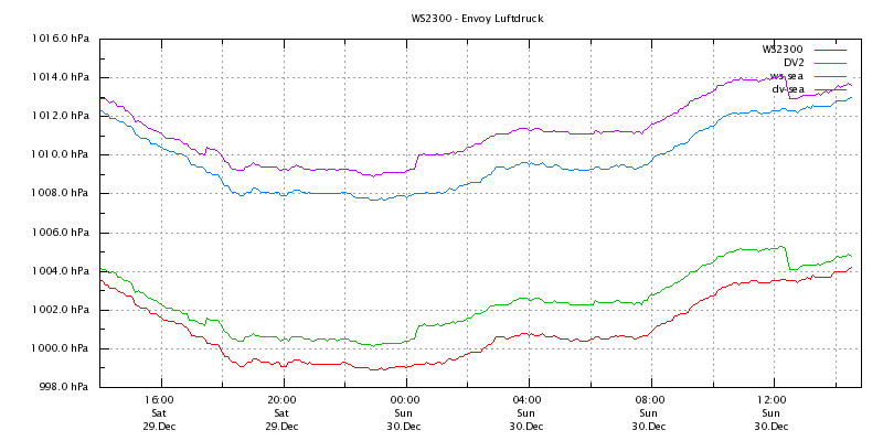

Compare presure between WS2300 (WS) and envoy (DV)<br />red/green local preasure, blue/pruple sea-level presure
Time in the graph is in CET, time from the dataview is in UTC.
Can somebody explain to me why the local preasure is changed as well in the data view when change the station hight!?
As you see the last value (see-lecel presure read from the Encoy) will not change, same I would expect for the local presure in the dataview.
Stations are mounted on the attic only about 30cm distance to each other, a 3port powerplug in between.
Temprature are the nearly the same, max difference is about .25°C
Humidity have a constant difference of about 8% between them.
regards
El

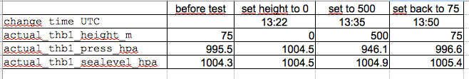

Now change the altitude in Meteohub to your normal station altitude, save and let the sensors refresh. Once they refresh, reload the webpage from above and record the values for pressure at the new altitude and compare the data.
Here I have done this and copied and paste my station values for altitude 826 meter and altitude 0 meters. I do not see the same thing you are seeing. Are you sure you are plotting the right values?

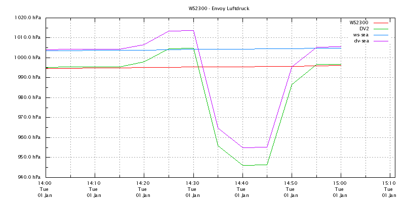

what you describe is exactly what I expected as well. Data I put in before was from the dataview menu. I have no idea why the graph looks that strange, seems there is some recalculation done after the change and after that it looks always somehow different.
I did the test like you suggested and what I see is that the actual_thb1_press_hpa change while the actual_thb1_sealevel_hpa stay in same range.
As you see the press_hpa is changed and sealevel_hpa stay in normal range. During the test timeframe the preassure was rising about +1 hpa, I see this as well on thb0 (my WS2300), so don't worry about that. Only change I did is going on the weatherstation menu on Metehub and change the station height and saved this change.
I stored as well the full output of http://THE IP ADDRESS OF YOUR METEOHUB STATION/meteograph.cgi?text=all if this is needed I can upload this.
After each change I create a new graph show thb0/1 and thb0/1-sea and looks very strange.
Hope this show why this confuse me, I don't understand why the local measured preasure is changed but not the sealevel.

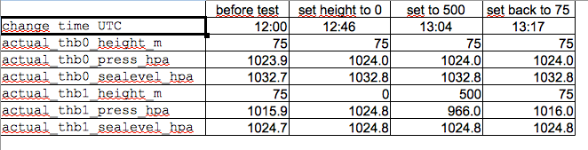

today I was on the location of my weatherstation and changed the settings in the Envoy ist self with Weatherlink software.
station elevation was on 75m change this to 0m
sea level barometer was empty and I let it empty
This changes was done at about 12:00 UTC. After that I collected again
press_hpa and sealevel_hpa for thb1 (Envoy) and thb0 (WS-2300).
As you see problem still the same, to me this looks like meteohub somehow take the local pressure of the Envoy as sealevel and calculate the local from that value by tacking the altitude.
When I read the data from the Envoy with weatherlink it self all looking as I expect them.
Any Idea if this could be fixed somehow by reconfiguration of my Meteohub installation or by change settings of the Envoy?
Is there any debug or verbose flag could be set via console to get out put of the data Meteohub fetch from the Envoy??
