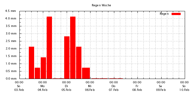

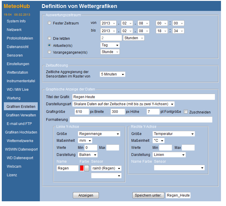

ive problem with my rain datas.
gnuplot show me for the today grapics this message in my PNG: No Data gnuplot execution failed
error message since yesterday, before everythink was ok.
i think the rain graphics for week and month are ok. i dont know whats the problem

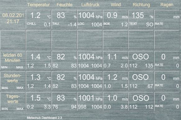

Dashboard:

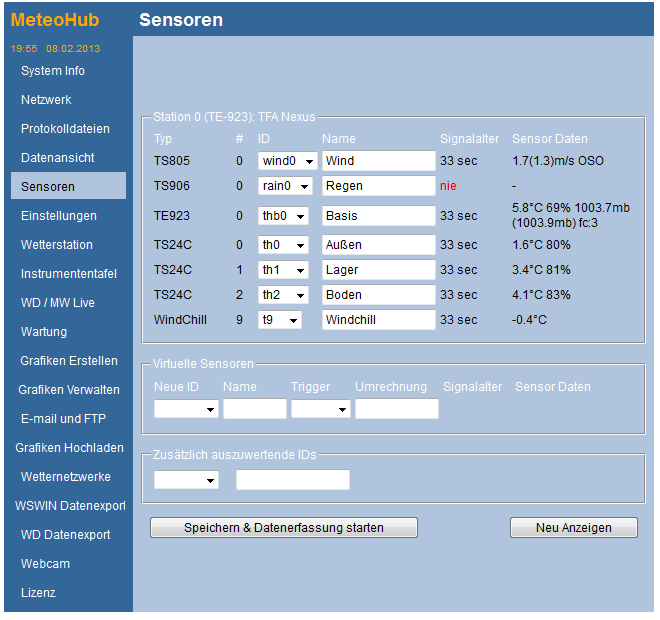

when the rain sensor is faulty or misplaced and does not send any data for a given period,
meteohub will show the "no data" tag when a graph is requested for this period.
Please try fxing your RF issue. Placing the rain sensor not directly onto the ground might be the
first step, as this is know to reduce lots of RF signal from it.
