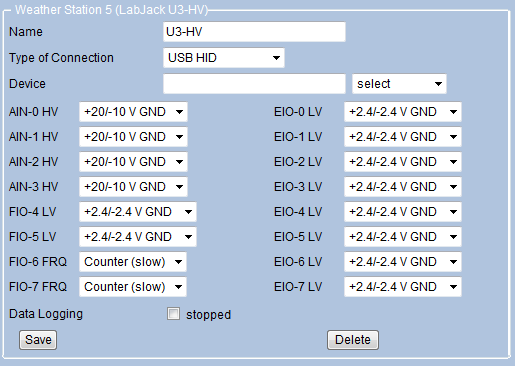

I've had a LabJack U3-HV for several years but not used it with Meteohub before. Now I want to monitor a 12V battery that I plan to use as part of a DC supply project (to replace a host of 12V 'wall wart' PSU's), so the U3-HV looks ideal, however none of the 4 'High Voltage'[1] inputs are showing up. Attached are the relevant bits of the Weather Station & Sensor pages:
I've made sure the U3-HV & Meteohub are both fully up to date (MH 4.9t running on ALIX.1D). If I attach the U3-HV to a Windows PC I can see the battery on AIN0 just fine.
Any ideas?
