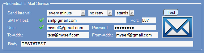

Please power cycle the unit to get todays latest bug fix.
Proven gmail settings are:
Gmail SMTP server address: smtp.gmail.com
Gmail SMTP user name: Your full Gmail address (e.g. example@gmail.com)
Gmail SMTP password: Your Gmail password
Gmail SMTP port: 587
Gmail SMTP auth method: STARTLS
