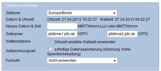

Please check your timezone settings.
herbertchen

Hm?
