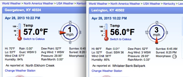

Image Here is a comparison of what meteohub is producing late in a day, compared to any other weatherbug station not on meteohub. I am noticing no rainfall is reporting for my station either which is being reported to other networks....

Weatherbug gust report will be changed to maximum gust of the day with next update.
Protocol definition I have, allows for reporting rain rate and daily rain.
Meteohub supports both values. So no idea why monthly rain does differ.
Does weather bug sum this up itself, or has a new parameter for this been invented?
