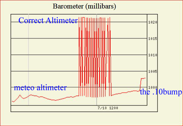

I let it run for a while and started checking the data uploads and (ratsfritz) it is doing just what I was afraid it would do and not reporting barometer correctly.
It was reporting sea level exactly 0.10 inches low but altimeter to CWOP was just really low. I used the built in barometer corrector and bumped up the sea level to match the correct pressure but the CWOP altimeter is still way low. Look at the chart.
So I don’t know where the problem is. I have not yet tried to connect directly to the console because I don’t want the bridge to change any of my console settings (not sure if it will do that but some other programs do).
So that’s where I am at right now. The thing seems to do exactly what is supposed to do except for CWOP. So for somebody looking for an easy way to send data to all the weather sites without having a computer running it may be a viable alternative.

the altimeter issue is strange, as i did quite some work on it in the past.
what station are you using, a davis vantage or vue?

Station is a vantage pro 2.
There has always been a problem with the Vantage stations reporting incorrect altimeter if they were at higher altitude. I am at 5032 ft.
VP Live is the only program that I have found really reports it correctly or at least the way CWOP seems to want it.
I am getting the data thru Virtual VP and not directly from the console so that may be causing it I will have to try a direct connect and see what happens.I can not do that right now I do not have a hub.

As Meteobridge does read LPS packets in addition to LOOP packets when fw version of Vantage is 1.90 or newer, using it without the VVP might make a difference as i don't know if VVP can handle that.
