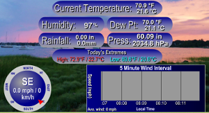

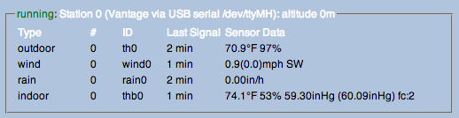

I'm seeing a weird oddity here. The raw data on the meteobridge and what is being sent to meteoplug and weatherunderground is showing correct. But they both are displaying the pressure as 60.09Hg. I'm not sure what is being pulled into these fields. Can you tell by the screenshots and log zip I attached.

Re: Meteobridge with Davis reporting erro
I guess it has to do with inconsistent altitude settings in console and Meteobridge.
Could you please reboot the Meteobridge?
After reading the code a bit, I give a second guess. Did you apply a manual "pressure correction" on "select station" tab?
If so, this is added to all pressure values but it is not applied to data uploaded to Meteoplug (which is a bug I will fix with next release).
