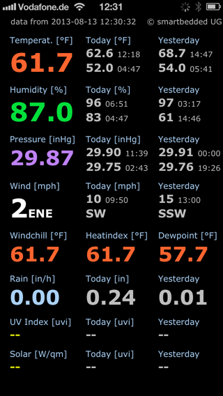

iPhone Integration (which is technically speaking making use of a small fraction of "Meteoplug Cloud Graphing") has been added to Meteobridge as a free give-away service. This service is offered on a best effort base, which means you can make use of it without subscribing to Meteoplug, unless it will hit paying Meteoplug users in terms of performance. We 'll see how far it goes....
Preparing your iPhone for Viewing your weather is done in a few simple steps.
  1. On "weather networks" page you find a new weather network named "Meteoplug Cloud Graphing". Select this service with a suitable upload interval for regular and live uploads.
  2. Select "Imperial" option when you prefer non-metric units.
  3. Press "Save" to store and activate your selection.
  4. When your iPhone has a QR code reader app installed, click onto the "iPhone QR" icon next to the live update interval field.
  5. A new window or browser tab will open which displays a QR code, which represents a URL. Scan that code with your QR code reader app and browse with Safari browser to the decoded URL. If you don't have a QR code reader, click onto the non-QR iPhone icon and mail the called URL to your iPhone to pick it up there and browse to it with Safari.
  6. Store URL from Safari onto your iPhone's home screen. It will appear with a Meteobridge icon on your iPhone's desktop, looking like an app.
  7. Leave Safari, click onto Meteobridge icon on home screen to start Safari again. This time Safari will start in full-screen mode.
  8. Now you can select from different views. Portrait view shows current data and todays and yesterdays min/max values in a tabular format. When you turn iPhone right into landscape, you will see a line chart for today and yesterday on temperature and wind and when you scroll down you can also see pressure and rain. When your turn iPhone left into landscape, you will see a dashboard with dials and gauges which updates up to every 10 seconds (the other views are loaded once when called, they will not update in the browser).
Remark: It needs a first upload before data can be received/displayed. So you have to wait a few minutes before data appears for the first time.
Attached you find some example screens from an iPhone 5. I hope you enjoy this add-on. Needless to say, that you are also welcome to test Meteoplug and to design more individual graphs with it. May be you like it :lol:

Re: iPhone Integration - as a free give-away
Post by kalen »
This is amazing!!!! However, I have got as far as it displaying the screen, but no data is showing?
Edit: Working now!
What is the difference between meteocloud and meteocloud (live)?

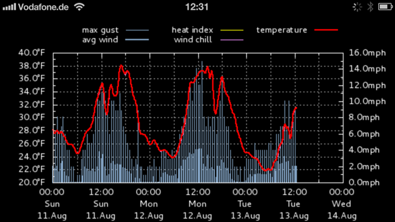

I don't know if you noticed, but the (F) scale is wrong..At least on the graph.. I was going to upload a pic, but your post shows it too.
Thanks for spotting this. The offset for Fahrenheit conversion was wrong. Please try angain.
RickNY
Posts: 30
Joined: Tue Aug 13, 2013 9:11 pm
Post by RickNY »
admin wrote:Thanks for spotting this. The offset for Fahrenheit conversion was wrong. Please try angain.
Looks good now :)

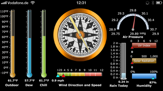

How do I view the graphs? All I can see is the instruments picture (last one of the post above). If I scroll down or to the side, it is just a black screen.
I have tried both landscape and portrait
RickNY
Posts: 30
Post by RickNY »
Portrait mode: current data
Rotate right to landscape: Graphs
Rotate left to landscape: Instruments
The graphs are scrollable
kalen
Posts: 27
Joined: Thu Jul 25, 2013 11:20 am
Post by kalen »
Ah cheers, :oops: :oops: :oops: :oops:
I must have been rotating it one way.
