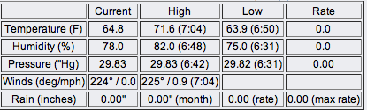

I noticed this for the first time last night when i realized that my MB had not been uploading data since the 14th (discussed by others in more detail below)
in my Weather Network tab i'm getting the red error message:
Error: WeatherBug: QueryString:Av Wd Spd Er::998.98554
and my WeatherBug Backyard credentials have an red X next to each line.
however, the LiveData tab shows uploading success (green checkmark) and if i got to the data page for my station (data.backyard2.weatherbug.com) i can see my current station data
any thoughts?
thanks!
r

Re: Error: WeatherBug: QueryString:Av Wd Spd Er::998.98554
I checked and this is just an error message that occurs when Meteobridge tries to verify connection with credentials but without current weather data.
Looks like weatherbug changed something that returns an error message on that attempts.
I will check with weatherbug, what I can do there.
But don't be alarmed it is just an error message on config screen, data on live data tab will be uploaded and status reported correctly.
