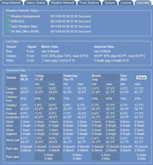

UPDATE, Meteobridge sensors were frozen for second time today. Did not show live data at all (from cca 10:35 till 12:00).

- meteo.jpg (162.11 KiB) Viewed 8381 times
Re: Wired Davis Vantage Pro2 ISS without USB pressure proble
This looks like a problem with connectivity of direct connect kit with weather station to me.
Can you cure the symptoms by disconnecting ISS from the connect kit an then connecting

Meteobridge runs for one day, then freeze again. I check a web interface to see what going on but MB restart himself. Then I unplug a cabel as you advice and MB send a really crazy amount of rain falls to internet, cca 2500mm/hour at first moment after reconnect. Then situation goes slowly to normal (no other crazy amount). I will check it in few hours to see whats going on...
UPDATE:
It is up and running, but did not know how long, because watch time period is too short. I will see more tommorow (after one day).

UPDATE 2 from 9:00 AM (22/9)
Situation is repeating, it did stop again. It is really not good at all
Stuck all night till reboot now
What can I do with this? Any solution?
