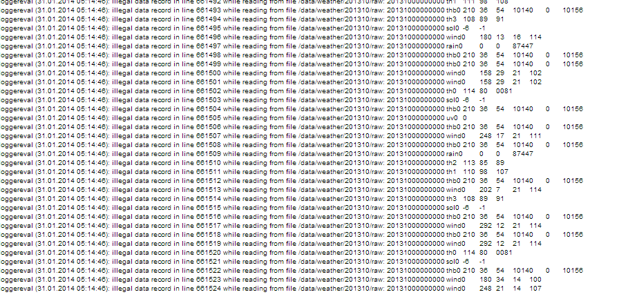

thanks for the reply, but recently the lines in the alarmlog changed, (see attached file), and what is a faulty storage media, is this the wmr data logger or the ALIX.1D box ???

it is the CF card in the ALIX box. Data is corrupt, as you can see in the example.
