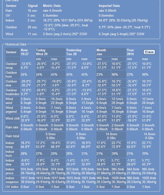

Logging into the Meteobridge shows (see attached screenshot):
1) Windchill on the live data tab is indeed 32F and the air temp is (for example) 9F
2) No sign of SL pressure data points at 40+ inHg
Any thoughts as to what is going on?

May have solved this - although I may also be in the wrong forum as well!
Windchill is only calculated above a certain windspeed - looks like it displays 32 F otherwise. Wish it just displayed the measured temperature.
Pressure - doh - I was using the =in converter in the web tag not =inHg - now thats fixed.
