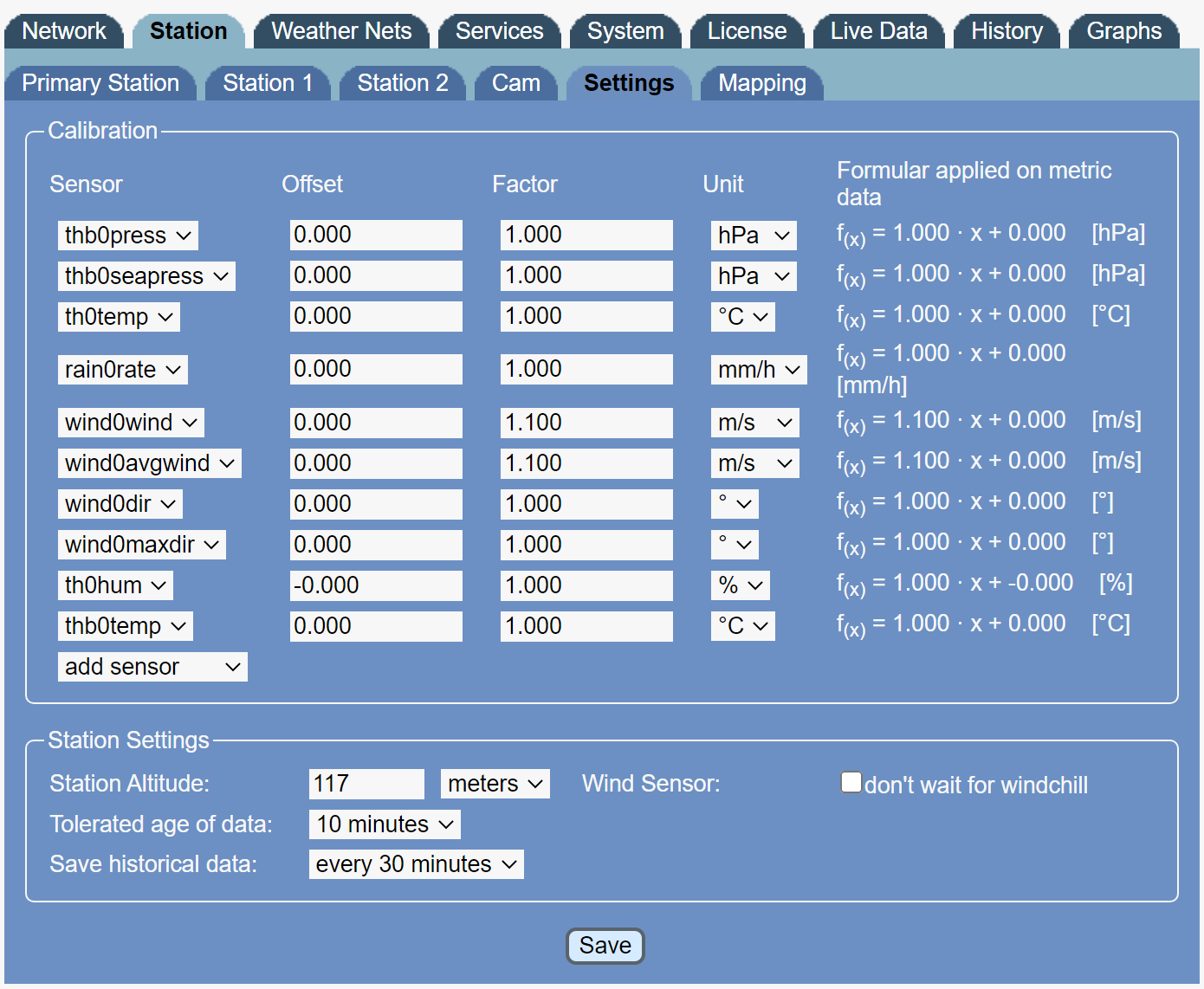

The ability to make this change and add a multiplier exists.
meteobridge settings.PNG (142.21 KiB) Viewed 1109 times
Both windspeeds wind0wind and wind0avgwind have been multiplied by 1.1 for my site.
