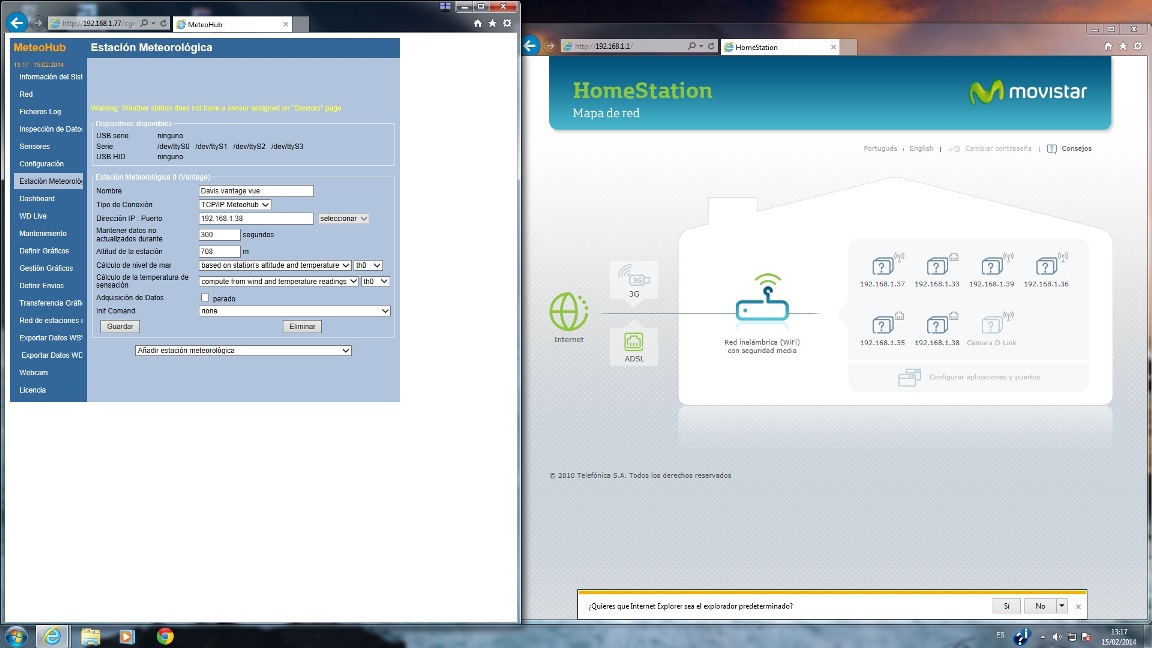

This is the screenshot of the settings to meteohub davis vue:
The ipa 192.168.1.35 is the IP that my router gives the weather station davis vue. What is wrong?
captura 1 meteohub peq.jpg (164.75 KiB) Viewed 13927 times
Re: Alix3D3 meteohub with weatherlink ip davis vue?
Don't choose "TCP/IP Meteohub" but "TCP/IP". The option you selected indicates that
the Meteohub should daisy-chain via TCP/IP to another Meteohub that has a weather station
connected.
