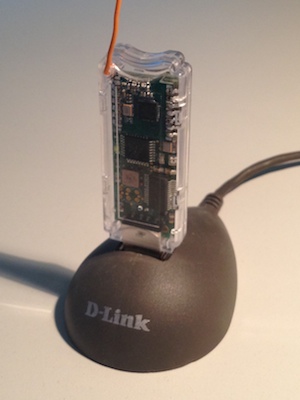

As you can see the Meteostick ist not shielded but exposes its components to the public through a transparent housing. As this looks appealing it also shows that there is not RF shielding around the RF chip. This is not a problem, as lab test show that now significant RF noise is generated by the Meteostick, but it makes the Meteostick somehow sensible for strong RF sources in direct neighborhood. I did some experiments putting the Meteostick directly into a WiFi connected Meteobridge and faced a significant drop in RF sensibility. Reason for that is that the WiFi signal emitted from the Meteobridge does render the Meteostick RF circuits partly blind, when WiFi signal is emitted.
So if you experience RF reception problems with your Davis sensors please use a USB interconnect cable to bring some space between your Meteobridge/Meteohub and the Meteostick. What might fit ideally is one of the USB base connectors as they are used with UMTS/3G sticks for the same reason. Using such a base as shown below did significantly improve RF reception with my test rig.
There are plenty of options in the Internet on aliexpress.com for small money.
Edit on April 13: Need for USB stand decreases when using Meteostick FW 1.2. But a USB stand is always a good investment to optimize position of Meteostick in regard to RF. There is also a cheap source for USB stands with a modestly magnetic foot in Germany:

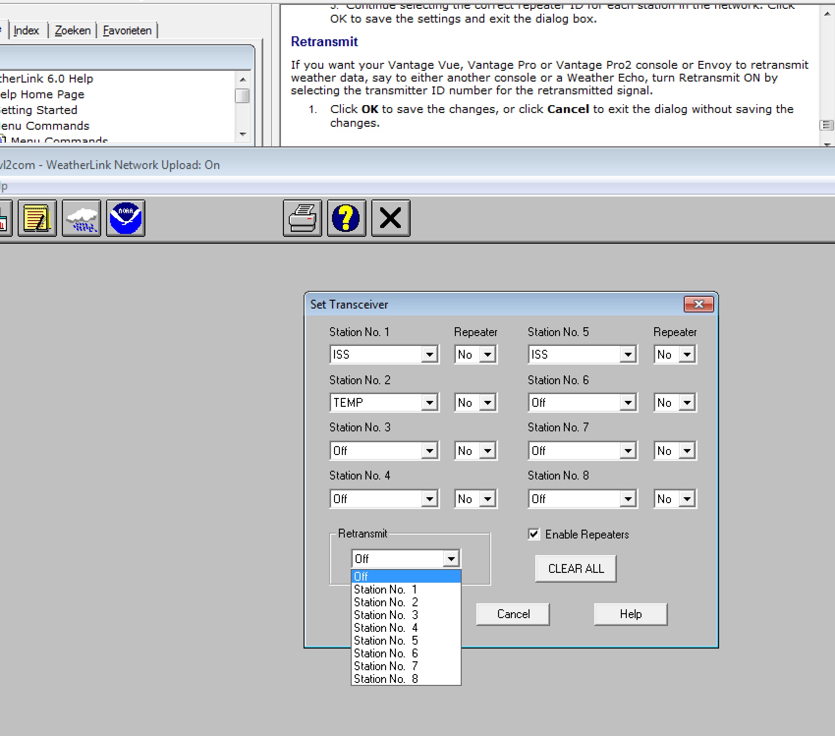

One is never sure: Console manual https://www.davisinstruments.com/produc ... _06312.pdf page 14:
But also the help file in Weatherlink and the "Set transciever window" is not clear about,
Envoy manual https://www.davisinstruments.com/produc ... _06316.pdf page 13/14Screen 3: Retransmit — Wireless Only
The console can retransmit the data it receives from the ISS to other Vantage Pro2 or Vantage Vue consoles using the retransmit feature. By toggling the feature on, the console becomes another transmitter that requires its own unique ID to transmit the data received from the ISS.
Data from the ISS is the only data that can be retransmitted by the console.
1. Press the + or - keys to turn the retransmit function on and off. The first available transmitter ID not used by the ISS or any optional sensor is automatically assigned.
I am confused also, only JeroenZwart can make sure by installing WeatherLink and then using the envoy as a repeater and check what the MB-Pro receives.Set Transceiver
Use the Set Transceiver dialog box to view and/or configure your Weather Envoy transmitter ID and repeater ID assignments and to control the retransmit function.
Note: Note: This dialog box is the only available tool for configuring the transmitter ID and repeater ID settings on your Weather Envoy.
Running the Software
To set transceiver options:
1. Select Set Transceiver from the Setup menu. The Set Transceiver dialog box displays.
2. Select a Station Type for each of the possible 8 transmitter IDs (“channels”) the Envoy may be receiving.
See the WeatherLink Online Help System for more information on configuring the stations, the retransmit feature, and configuring the Envoy for using repeaters.
- repeater.jpeg (376.63 KiB) Viewed 23367 times
