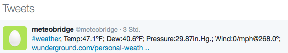

Re: Help With Twitter - Duplicate Tweet Error
I tried, but cannot reproduce the problem. "%20" is displayed correctly as a space with all browsers I used.
#weather, Temp:[th0temp-act=F.1:--]ºF; Dew:[th0dew-act=F.1:--]ºF; Pressure:[thb0press-act=inHg.2:--]in.Hg.; Wind:[wind0wind-act=mph.0:--]/mph@[wind0dir-act:--]º;http://www.wunderground.com/personal-weather-station/dashboard?ID=KPAPERKA4
results to (including spaces):
Screen Shot 2014-05-02 at 03.52.01.png (24.05 KiB) Viewed 4077 times
