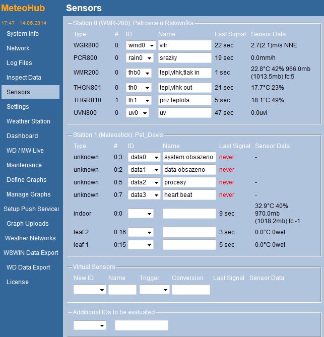

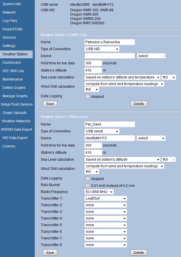

If I connect the meteostick to the sheevaplug, I don´t see the sensors from Davis and I see 4 system sensors. I tried connect meteostick together with wmr200, than I tried connect meteostick direct to sheevaplug (without hub and other meteostation) and without success.
You can see this problem on pictures in attachment.

As you can see there is no data provided for the "system sensors" which are just a relict from a former configuration of a system sensor as station#1.
just delete the sensors by selecting the blank field from ID drop-down list and pressing "save".
I wonder that you have selected Leaf/Soil as station type instead of ISS. Are you sure you have a Leaf/Soil sensor from Davis only? No ISS?

thanks, I removed the faulty sensors.
Yes, I have as second meteostation only meteostick + Wireless Leaf & Soil Moisture/Temperature Station with sensors (1x leaf sensor and 4x soil moisture sensors). (The ISS will be in second round)
But I see (picture in attachment) only sensor from meteostick and "leaf 2" sensor (btw leaf sensor is connected into position 1 in station) and nothing more.

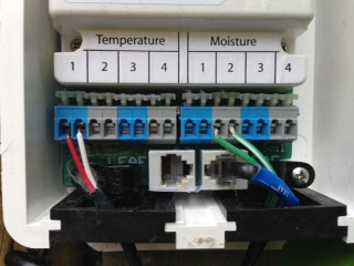

These leaf/soil configurations are a bit tricky. Can you provide me access on port 22 to your Meteohub,
then I can check details. Please email to "info(at)meteohub.de".
I checked with my leaf/soil station and when I connect a soil sensor to any of the free ports it shows up as a soil sensor there.
Please see connection terminal configuration and resulting meteohub sensors below.
what is your exact configuration at the connection terminal?
Does "meteohub log" show errors related to the not displayed sensors?

Re: Problem with connection meteostick + sheevaplug
Solved with new version 4,9z
