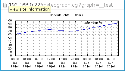

There is no unit name on the soil image, when I have chosen 'cbar' ;
'percent' works well.
Best Regards
Joachim

Can be worked around with a gnu plot format string. There should be lots of format cmd examples in the forum.

[quote="admin"There should be lots of format cmd examples in the forum.[/quote]
What is the item for searching?

Gnuplot format
You also should have a look into gnuplot manual to get the right command from there.

I insert in the second line ot the 'plot image' bodenfeuchte.mg
format set_ylabel_"Feuchte_[cbar]"
