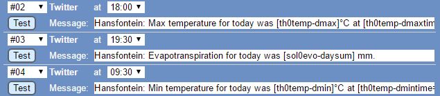

Ok, so you're saying it's fixed and I am still experiencing an exact replica of what is described by the OP of this old thread. Then maybe there is some fringe scenario where the old bug re-occurs? Or maybe it's something new? Do you have any suggestions on where I could start looking for the problem? If I had access to the source code I could probably figure it out on my own, but now I don't... :wink:
The attached screen grab is the only way I can get a tweet to fire at a specific time.

Herewith a screenshot of the "Specific Time" events that do not fire.
