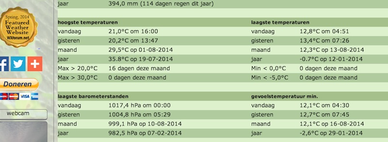

After much experience with all kind of weatherprograms in the past three years, I still prefer the meteohub data format, although with hindsight an extra T between the data and the time part whould have been a more standardized form 20140816T003138 to process.
I attached a small portion of my trends page with Meteohub data and times. now in human readable form.
Please explain a little more, what exactly is it that you want to be different?
