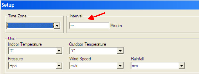

Ups, I meant EasyWeather. This is the software, which is delivered with the weather station .
Here, for example, the memory interval can be put for the internal memory. My question is whether this setting can interfere the transmission to Meteohub?
If I put, for example, with the station 30 minutes, with Meteohub, however, 2 minutes, the transference stops in Meteohub after a while.
The background is only that I would like to relieve, actually, the internal memory of the station; since if this is full, the transference also pauses in Meteohub apparently.
- easyweather-Setup.png (58.52 KiB) Viewed 15323 times

This is clear, the settings for the station occur of course before connecting to Meteohub.
My supposition is if the interval of the station is put, e. g. , on 30 minutes, Meteohub in this time no topical values can call away.
Then under circumstances an internal time stamp of the station blocks in this time topical logging of the values in Meteohub?
But this is only one pure supposition of me. I had, in any case, the day before yesterday the case that the internal memory WH-1080 was full and then no more values came in Meteohub. When I had put the interval of the station on 30 minutes, no more values were stored after approx. 1 hour also in Meteohub. When I had put the interval of the station again on 5 minutes (the smallest value), everything ran again easily...
