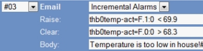

I set up an incremental alarm this morning for a "<" temperature condition as shown below. I do see that the clear should have been an even integer. It was silent for a couple of hours but then when I was out it ran away, producing over 1,000 emails, about 16 each minute.
- Is there a way to set the incremental time?
- Is there a way I set up a clear condition that grabs the time of the first alarm pushed email and stops it? A version perhaps of this string but I don't know how to grab the first alarm time.
viewtopic.php?f=56&t=9713&p=14953&hilit=alarm#p14953
- MeteoPlug 4.jpg (55.07 KiB) Viewed 9727 times

your conditions don't look good to me.
1) for incremental alarms, I would recommend to use the "complex condition expressions"
2) the conditions you state don't make sense when temp is at 69.0 F. Now the raise and clear are both triggered,
which will result into the email storm you experienced.
What do you want to achieve? When you state that a sentence, we can help to draft the expressions.

to get an incremental alarm on decline below 45F you might use these lines.
raise (incremental):
clear:
msg:
45 - [thb0temp-act=F.0:45]Code: Select all
[thb0temp-act=F.0:0] - 45Code: Select all
Warning: Indoor temp dropped to [thb0temp-act=F.1:--]°F at [hh]:[mm]- assenzuid
