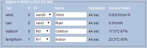

i have a EVL-WDE1 receiver unit and a the weather station ELV KS 300. I have the problem that the rain sensor is not detected. It's a boolean value, 1 for rain and 0 for no rain.
The Weather stations sends the data in following format:
$1;1;;;;;;12,9;;;;;;;;58;;;;18,8;40;0,0;2680;0;0
The first three fields are constant, the temperature readings follow (° C) of the eight sensors (for example, S 300) and then the moisture content (%) values ​​of the eight sensors. Then temperature come (° C), humidity (%), wind speed (km / h), precipitation (rocker beats) and rain sensor (0/1) of the combination sensor KS 200 or KS 300 The last field with the constant value 0 stands for the the end of the record.
I know that the value will be received but how can i read the value?
