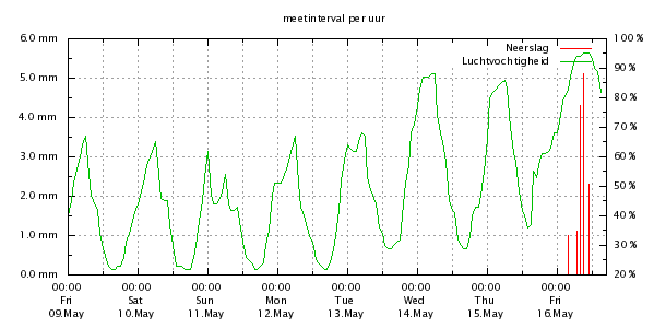

today it was the first day in 3 weeks that we got some rain here in the netherlands. this graph shows that perfectly (it displays the last week):

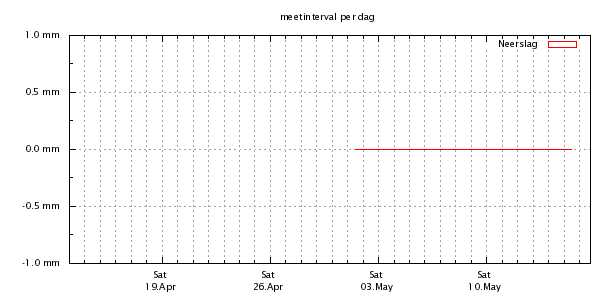

but then the graph showing the last 4 weeks (aggregation of 1 day) displays nothing yet:
shouldn't that one display the total amount for this day already?

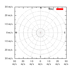

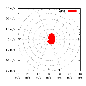

the same situation occurs in the wind-direction graphs:
last day
last 4 weeks
the aggregation for the last graph is set on 1 month, because i read somewhere on the forum here that that is the 'duration' of the data (in case of radar-graphs). but then again, nothing is display. should i wait till the month is over?

data for graphs is available shortly after the timeframe under consideration is finished. So if you are graphing based on daily values (time resolution 1 day), you get the data for friday, when saturday starts.

that explains the rain-graph above. it will show the rain of today by tomorrow then.
but what about the wind-radar? aggregation has to be set to 1 month (as described in this topic http://www.meteohub.de/joomla/index.php ... 6&catid=13). will it start displaying data after a full month? and then update everyday? (since the time-frame is set to 'last 4 weeks' and the aggregation to 1 month)

I would propose to work with time frame \"last month\" and time resolution \"1 month\" to get the graph of the last month as a monthly summary of wind directions.
the \"last 4 weeks\" time frame will not work, because when you have middle of may for example, this will reach back until middle of april. but data for april is dated 20080401000000, so april data will be out of range and you get an empty graph.
