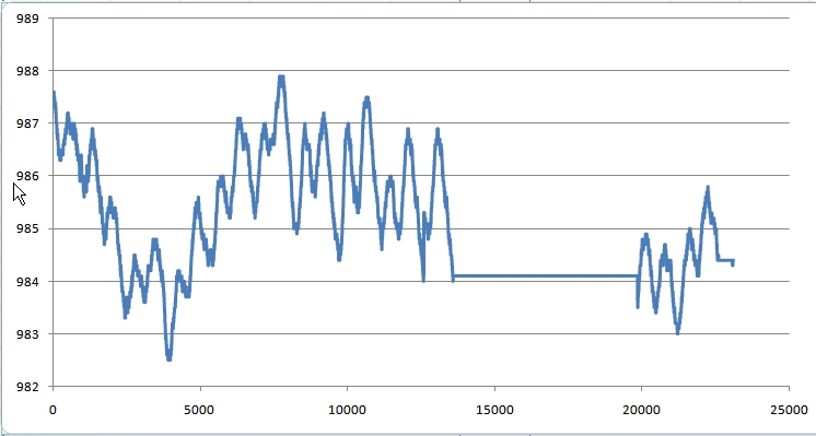

I attached a plot to show the problem. The plot shows 16 days of barometric pressure. The Meteohub was powered down for 4.5 days. See the flat part? That's when Meteohub was powered down yet when I do a data export the log file shows 984.1mbar during that time period. I would rather there be no data than have invalid data.

I understand what you're saying but that's not the case here. I made that plot with Excel and it is an X-Y Scatter chart, which can plot discontinuous data.
The invalid data is in the log file! Below is a snippet of the data:

You can see the date, time, temperature, dew point (?) and pressure. Its as if Meteohub filled in the empty time period with the last valid data point.
So my question is, is this the way Meteohub is supposed to operate?? Or am I doing something wrong?

I can plot the data from the Meteohub web page (using points, not lines) and there is no data when the Meteohub was powered off. So that means there is no data in the raw data files. However when I *export* data to WSWIN or WD data, Meteohub is filling in the empty time with invalid data. I need to figure out how to fix this...
It's not doing it on just one unit, all of my units (4) do this.
