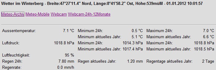

i use the variable [year1_rain0_days] and today (1st january 2012) Meteohub shows 2 rain days. Why ?

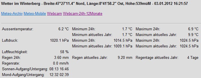

Today (2012-01-03) i made the update from 4.8f to 4.8i. After the recalcuation of the data, i got 4 raindays for 2012 ! We had rain on the 1st and 2nd january and this gives 2 raindays !

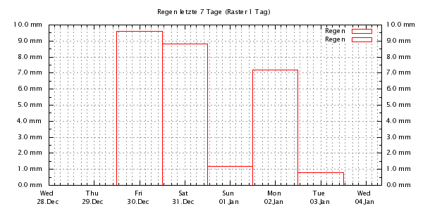

Correction of my posting yesterday. We had rain on all 3 days (1.-3.1.2012) and i should have now 3 raindays. Meteohub still shows 4 raindays today (4.1.2012).
