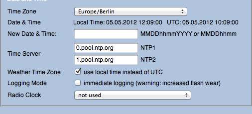

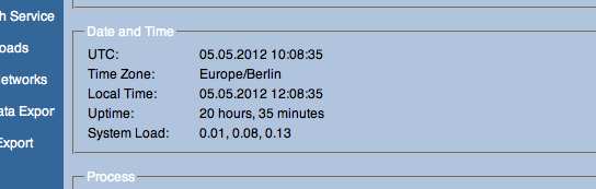

is time zone set correctly?
Re: DC01 NEW box,disc,latest release: NO FTP and more errors
Checked that, forget to tell it in my post. Time settings seem OK to me.
