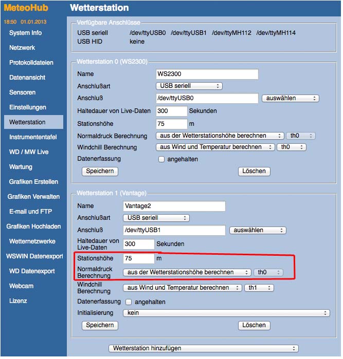

El,
When I looked back at this email picture, I see you had selected th0 for your sensor for the Envoy. Should it have been th1 or is this because you still do not have your ISS yet?

Hi David,
just back home.
I unplugged the old weatherstation physically from USB Port of the iConnect, deleted it from weather station menu and reload meteohub. But problem is still the same.
actual_thb1_height_m 75
actual_thb1_press_hpa 1015.4
actual_thb1_sealevel_hpa 1024.2
When I compare with local stations, Airport FMO (about 13km North,FMO on wetteronline.de) and local university station (about 3.7km South, show only local pressure, Institute of Landscape Ecology of the University of Muenster) the value shown as sealevel here seems to be the local pressure.
When I checked the data I loaded from the logger to the Davis Weatherlink software it show only the sealevel value which was at about 1031 this morning when the station altitude was still on 75m in the Envoy and goes down to about 1024 when I change it to 0m.
When I read you last post it seems you see what I find suspect here now as well. Looks to me like somehow the local presure is used as sealevel and the local one is calculated from that one by using the station altitude.
Even more strange to me is that it don't madder if configure in the weather station menu if the sealevel claculation should be "based on station's altitude" or "use reading from weatherstation" the values shown in the sensors tab or on <meteohub URL>/meteograph.cgi?text=all pressure values are the same for both.
To answer your question with the th0, this is greyed out for the used options and metehub switch is always back to th0 and currently there is even no th1 and the ISS isn't installed yet.
It is only selectable if you use "based on station's altitude and temperature.
Is there any possebillity, maybe via SSH, to do a reset of all weatherstation data without deleting the network settions, as my iConnect is connected via WLAN and I have no ethernet I need to remove it from location to an other room to do a full reset, as I assue that the reset under maintenace will reset as well the network settings. This might the last option I can do, as the Envoy is still shown as station1 and there seems to be some data form station0 (WS2300) in the system, maybe worth to get rid of all of them. If this will not fix this, I'm totally out of ideas.

I will go to station location and set altitude back into the Envoy, this seems to be at least a workaround to get good pressure values, even if I can't change them via meteohub.
vy73
EL
