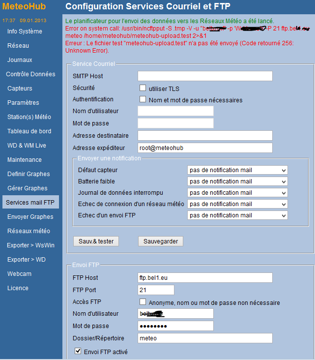

I want to change server, "skynet.be" to server "ovh.com." lorsaue I put in the necessary information Meteohub I get this:
"Error on call system: / usr / bin / ncftpput-S.-V-u tmp" beltxmvf "-p 'XXXXXX' P-21 ftp.bel1.eu / Weather / home / Meteohub / Meteohub upload.test-2> & 1
Error: The file test "Meteohub-upload.test" has not been sent (returned code 1280: Unknown Error). "
with fiezella or "total commander", there is no connection problem
the / meteo is chmod 705
What is my problem?

- meteohub_ftpcapt.jpg (171.03 KiB) Viewed 11071 times

The folder name ("Dossier Répertoire") should be included in slashes: /meteo/

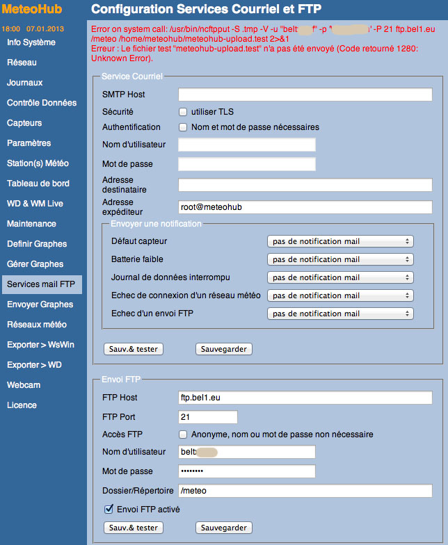

Sorry
but the error is always the same. exept the code 258
thank you for your help

I do not use slashes at all and it works!
