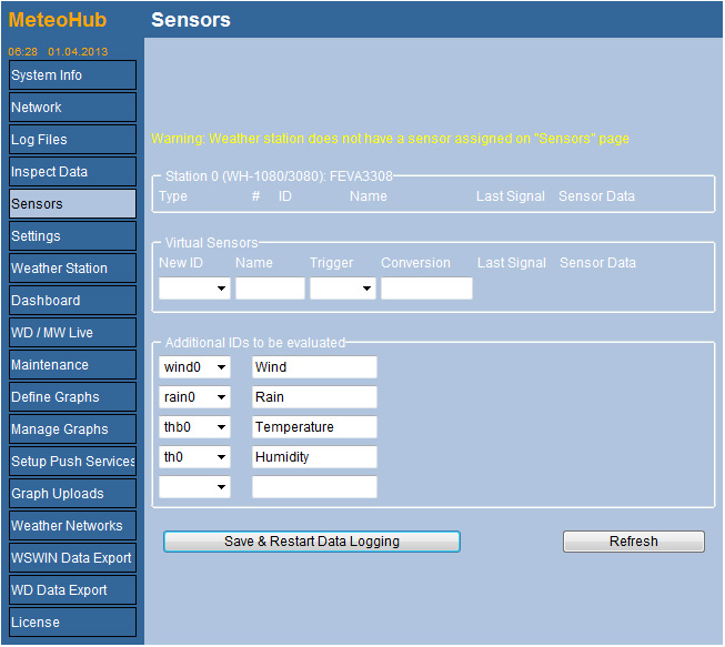

I have a WS-1090 from AmbientWeather.com and the SheevaPlug. The display shows all sensor data; however, the SheevaPlug does not detect the sensors. It was working fine until 3/9/2013. At that point the sensors could not be detected. I upgraded the firmware to 4.9t. The Weather Station is detected under USB HID. However the error message displays "Warning: Weather station does not have a sensor assigned on "Sensors" page." On the Sensors page the following is shown:
Station 0 (WH-1080/3080): StationName
Type # ID Name Last Signal Sensor Data
Virtual Sensors
New ID Name Trigger Conversion Last Signal Sensor Data
Additional IDs to be evaluated
As you can see, the sensors are not regiistering with the SheevaPlug, but they do register with the display.
What can I do to fix this?
Thank you,
MDuncan

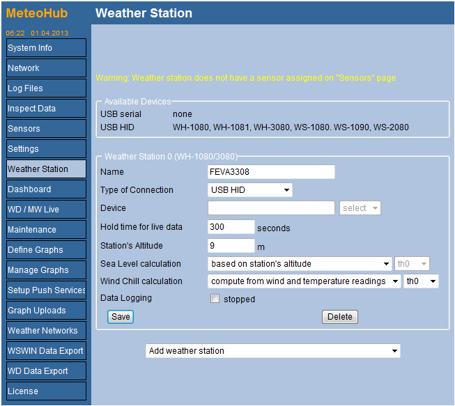

could you please post your "weather station" page?
Re: SheevaPlug Lost Sensors
The Weather Station page is attached as well as the Sensors page.
- sensors.jpg (159 KiB) Viewed 18989 times
- weatherstation.jpg (182.5 KiB) Viewed 18989 times
weather station page looks ok to me. additional sensor definition does not make sense here, but as no sensor data is displayed, this is not the root cause of the problem.

logger (01.04.2013 20:34:48): data logger (version 4.9t, build 1216) started.
logger (01.04.2013 20:34:48): connect station 0 (WH-1080/3080 via USB HID).
logger (01.04.2013 20:40:18): child process received timeout signal (14).
logger (01.04.2013 20:40:18): disconnect station 0 (WH-1080/3080).
logger (01.04.2013 20:40:21): data logger stopped.
logger (01.04.2013 20:40:21): data logger (version 4.9t, build 1216) started.
logger (01.04.2013 20:40:22): connect station 0 (WH-1080/3080 via USB HID).
logger (01.04.2013 20:45:52): child process received timeout signal (14).
logger (01.04.2013 20:45:52): disconnect station 0 (WH-1080/3080).
logger (01.04.2013 20:45:55): data logger stopped.
logger (01.04.2013 20:45:55): data logger (version 4.9t, build 1216) started.
logger (01.04.2013 20:45:55): connect station 0 (WH-1080/3080 via USB HID).
logger (01.04.2013 20:51:25): child process received timeout signal (14).
logger (01.04.2013 20:51:25): disconnect station 0 (WH-1080/3080).
logger (01.04.2013 20:51:27): data logger stopped.
logger (01.04.2013 20:51:27): data logger (version 4.9t, build 1216) started.
logger (01.04.2013 20:51:28): connect station 0 (WH-1080/3080 via USB HID).
logger (01.04.2013 20:56:58): child process received timeout signal (14).
logger (01.04.2013 20:56:58): disconnect station 0 (WH-1080/3080).
logger (01.04.2013 20:57:01): data logger stopped.
logger (01.04.2013 20:57:01): data logger (version 4.9t, build 1216) started.
logger (01.04.2013 20:57:01): connect station 0 (WH-1080/3080 via USB HID).
logger (01.04.2013 21:02:31): child process received timeout signal (14).
logger (01.04.2013 21:02:31): disconnect station 0 (WH-1080/3080).
logger (01.04.2013 21:02:34): data logger stopped.
logger (01.04.2013 21:02:34): data logger (version 4.9t, build 1216) started.
logger (01.04.2013 21:02:34): connect station 0 (WH-1080/3080 via USB HID).
logger (01.04.2013 21:08:04): child process received timeout signal (14).
logger (01.04.2013 21:08:04): disconnect station 0 (WH-1080/3080).
logger (01.04.2013 21:08:07): data logger stopped.
logger (01.04.2013 21:08:07): data logger (version 4.9t, build 1216) started.
logger (01.04.2013 21:08:08): connect station 0 (WH-1080/3080 via USB HID).
logger (01.04.2013 21:13:38): child process received timeout signal (14).
logger (01.04.2013 21:13:38): disconnect station 0 (WH-1080/3080).
logger (01.04.2013 21:13:40): data logger stopped.
logger (01.04.2013 21:13:40): data logger (version 4.9t, build 1216) started.
logger (01.04.2013 21:13:41): connect station 0 (WH-1080/3080 via USB HID).
logger (01.04.2013 21:19:11): child process received timeout signal (14).
logger (01.04.2013 21:19:11): disconnect station 0 (WH-1080/3080).
logger (01.04.2013 21:19:14): data logger stopped.
logger (01.04.2013 21:19:14): data logger (version 4.9t, build 1216) started.
logger (01.04.2013 21:19:14): connect station 0 (WH-1080/3080 via USB HID).
logger (01.04.2013 21:24:44): child process received timeout signal (14).
logger (01.04.2013 21:24:44): disconnect station 0 (WH-1080/3080).
logger (01.04.2013 21:24:47): data logger stopped.
logger (01.04.2013 21:24:47): data logger (version 4.9t, build 1216) started.
logger (01.04.2013 21:24:48): connect station 0 (WH-1080/3080 via USB HID).
logger (01.04.2013 21:30:18): child process received timeout signal (14).
logger (01.04.2013 21:30:18): disconnect station 0 (WH-1080/3080).
logger (01.04.2013 21:30:21): data logger stopped.
logger (01.04.2013 21:30:21): data logger (version 4.9t, build 1216) started.
logger (01.04.2013 21:30:22): connect station 0 (WH-1080/3080 via USB HID).
logger (01.04.2013 21:35:52): child process received timeout signal (14).
logger (01.04.2013 21:35:52): disconnect station 0 (WH-1080/3080).
logger (01.04.2013 21:35:54): data logger stopped.
logger (01.04.2013 21:35:54): data logger (version 4.9t, build 1216) started.
logger (01.04.2013 21:35:55): connect station 0 (WH-1080/3080 via USB HID).
logger (01.04.2013 21:41:25): child process received timeout signal (14).
logger (01.04.2013 21:41:25): disconnect station 0 (WH-1080/3080).
logger (01.04.2013 21:41:28): data logger stopped.
logger (01.04.2013 21:41:28): data logger (version 4.9t, build 1216) started.
logger (01.04.2013 21:41:28): connect station 0 (WH-1080/3080 via USB HID).
logger (01.04.2013 21:46:58): child process received timeout signal (14).
logger (01.04.2013 21:46:58): disconnect station 0 (WH-1080/3080).
logger (01.04.2013 21:47:04): data logger stopped.
logger (01.04.2013 21:47:04): data logger (version 4.9t, build 1216) started.
logger (01.04.2013 21:47:05): connect station 0 (WH-1080/3080 via USB HID).
logger (01.04.2013 21:52:35): child process received timeout signal (14).
logger (01.04.2013 21:52:35): disconnect station 0 (WH-1080/3080).
logger (01.04.2013 21:52:39): data logger stopped.
logger (01.04.2013 21:52:39): data logger (version 4.9t, build 1216) started.
logger (01.04.2013 21:52:39): connect station 0 (WH-1080/3080 via USB HID).
logger (01.04.2013 21:58:09): child process received timeout signal (14).
logger (01.04.2013 21:58:09): disconnect station 0 (WH-1080/3080).
logger (01.04.2013 21:58:12): data logger stopped.
logger (01.04.2013 21:58:12): data logger (version 4.9t, build 1216) started.
logger (01.04.2013 21:58:12): connect station 0 (WH-1080/3080 via USB HID).
logger (01.04.2013 22:03:42): child process received timeout signal (14).
logger (01.04.2013 22:03:42): disconnect station 0 (WH-1080/3080).
logger (01.04.2013 22:03:45): data logger stopped.
logger (01.04.2013 22:03:45): data logger (version 4.9t, build 1216) started.
logger (01.04.2013 22:03:46): connect station 0 (WH-1080/3080 via USB HID).
logger (01.04.2013 22:09:16): child process received timeout signal (14).
logger (01.04.2013 22:09:16): disconnect station 0 (WH-1080/3080).
logger (01.04.2013 22:09:18): data logger stopped.
logger (01.04.2013 22:09:18): data logger (version 4.9t, build 1216) started.
logger (01.04.2013 22:09:19): connect station 0 (WH-1080/3080 via USB HID).
logger (01.04.2013 22:14:49): child process received timeout signal (14).
logger (01.04.2013 22:14:49): disconnect station 0 (WH-1080/3080).
logger (01.04.2013 22:14:51): data logger stopped.
logger (01.04.2013 22:14:51): data logger (version 4.9t, build 1216) started.
logger (01.04.2013 22:14:52): connect station 0 (WH-1080/3080 via USB HID).
logger (01.04.2013 22:20:22): child process received timeout signal (14).
logger (01.04.2013 22:20:22): disconnect station 0 (WH-1080/3080).
logger (01.04.2013 22:20:24): data logger stopped.
logger (01.04.2013 22:20:24): data logger (version 4.9t, build 1216) started.
logger (01.04.2013 22:20:24): connect station 0 (WH-1080/3080 via USB HID).
logger (01.04.2013 22:25:54): child process received timeout signal (14).
logger (01.04.2013 22:25:55): disconnect station 0 (WH-1080/3080).
logger (01.04.2013 22:25:58): data logger stopped.
logger (01.04.2013 22:25:58): data logger (version 4.9t, build 1216) started.
logger (01.04.2013 22:25:58): connect station 0 (WH-1080/3080 via USB HID).
logger (01.04.2013 22:31:28): child process received timeout signal (14).
logger (01.04.2013 22:31:28): disconnect station 0 (WH-1080/3080).
logger (01.04.2013 22:31:31): data logger stopped.
logger (01.04.2013 22:31:31): data logger (version 4.9t, build 1216) started.
logger (01.04.2013 22:31:31): connect station 0 (WH-1080/3080 via USB HID).
logger (01.04.2013 22:37:01): child process received timeout signal (14).
logger (01.04.2013 22:37:01): disconnect station 0 (WH-1080/3080).
logger (01.04.2013 22:37:04): data logger stopped.
logger (01.04.2013 22:37:04): data logger (version 4.9t, build 1216) started.
logger (01.04.2013 22:37:04): connect station 0 (WH-1080/3080 via USB HID).
logger (01.04.2013 22:42:34): child process received timeout signal (14).
logger (01.04.2013 22:42:34): disconnect station 0 (WH-1080/3080).
logger (01.04.2013 22:42:37): data logger stopped.
logger (01.04.2013 22:42:37): data logger (version 4.9t, build 1216) started.
logger (01.04.2013 22:42:37): connect station 0 (WH-1080/3080 via USB HID).
logger (01.04.2013 22:48:07): child process received timeout signal (14).
logger (01.04.2013 22:48:07): disconnect station 0 (WH-1080/3080).
logger (01.04.2013 22:48:10): data logger stopped.
logger (01.04.2013 22:48:10): data logger (version 4.9t, build 1216) started.
logger (01.04.2013 22:48:11): connect station 0 (WH-1080/3080 via USB HID).
logger (01.04.2013 22:53:41): child process received timeout signal (14).
logger (01.04.2013 22:53:41): disconnect station 0 (WH-1080/3080).
logger (01.04.2013 22:53:44): data logger stopped.
logger (01.04.2013 22:53:44): data logger (version 4.9t, build 1216) started.
logger (01.04.2013 22:53:44): connect station 0 (WH-1080/3080 via USB HID).
logger (01.04.2013 22:59:14): child process received timeout signal (14).
logger (01.04.2013 22:59:14): disconnect station 0 (WH-1080/3080).
logger (01.04.2013 22:59:17): data logger stopped.
logger (01.04.2013 22:59:17): data logger (version 4.9t, build 1216) started.
logger (01.04.2013 22:59:17): connect station 0 (WH-1080/3080 via USB HID).
logger (01.04.2013 23:04:47): child process received timeout signal (14).
logger (01.04.2013 23:04:47): disconnect station 0 (WH-1080/3080).
logger (01.04.2013 23:04:50): data logger stopped.
logger (01.04.2013 23:04:50): data logger (version 4.9t, build 1216) started.
logger (01.04.2013 23:04:51): connect station 0 (WH-1080/3080 via USB HID).
logger (01.04.2013 23:10:21): child process received timeout signal (14).
logger (01.04.2013 23:10:21): disconnect station 0 (WH-1080/3080).
logger (01.04.2013 23:10:24): data logger stopped.
logger (01.04.2013 23:10:24): data logger (version 4.9t, build 1216) started.
logger (01.04.2013 23:10:24): connect station 0 (WH-1080/3080 via USB HID).
logger (01.04.2013 23:15:54): child process received timeout signal (14).
logger (01.04.2013 23:15:54): disconnect station 0 (WH-1080/3080).
logger (01.04.2013 23:15:57): data logger stopped.
logger (01.04.2013 23:15:57): data logger (version 4.9t, build 1216) started.
logger (01.04.2013 23:15:57): connect station 0 (WH-1080/3080 via USB HID).
logger (01.04.2013 23:21:27): child process received timeout signal (14).
logger (01.04.2013 23:21:28): disconnect station 0 (WH-1080/3080).
logger (01.04.2013 23:21:31): data logger stopped.
logger (01.04.2013 23:21:31): data logger (version 4.9t, build 1216) started.
logger (01.04.2013 23:21:31): connect station 0 (WH-1080/3080 via USB HID).
logger (01.04.2013 23:27:01): child process received timeout signal (14).
logger (01.04.2013 23:27:01): disconnect station 0 (WH-1080/3080).
logger (01.04.2013 23:27:04): data logger stopped.
logger (01.04.2013 23:27:04): data logger (version 4.9t, build 1216) started.
logger (01.04.2013 23:27:04): connect station 0 (WH-1080/3080 via USB HID).
logger (01.04.2013 23:32:34): child process received timeout signal (14).
logger (01.04.2013 23:32:34): disconnect station 0 (WH-1080/3080).
logger (01.04.2013 23:32:37): data logger stopped.
logger (01.04.2013 23:32:37): data logger (version 4.9t, build 1216) started.
logger (01.04.2013 23:32:38): connect station 0 (WH-1080/3080 via USB HID).
logger (01.04.2013 23:38:08): child process received timeout signal (14).
logger (01.04.2013 23:38:08): disconnect station 0 (WH-1080/3080).
logger (01.04.2013 23:38:11): data logger stopped.
logger (01.04.2013 23:38:11): data logger (version 4.9t, build 1216) started.
logger (01.04.2013 23:38:12): connect station 0 (WH-1080/3080 via USB HID).
logger (01.04.2013 23:43:42): child process received timeout signal (14).
logger (01.04.2013 23:43:42): disconnect station 0 (WH-1080/3080).
logger (01.04.2013 23:43:46): data logger stopped.
logger (01.04.2013 23:43:46): data logger (version 4.9t, build 1216) started.
logger (01.04.2013 23:43:46): connect station 0 (WH-1080/3080 via USB HID).
logger (01.04.2013 23:49:16): child process received timeout signal (14).
logger (01.04.2013 23:49:16): disconnect station 0 (WH-1080/3080).
logger (01.04.2013 23:49:19): data logger stopped.
logger (01.04.2013 23:49:19): data logger (version 4.9t, build 1216) started.
logger (01.04.2013 23:49:20): connect station 0 (WH-1080/3080 via USB HID).
logger (01.04.2013 23:54:50): child process received timeout signal (14).
logger (01.04.2013 23:54:50): disconnect station 0 (WH-1080/3080).
logger (01.04.2013 23:54:52): data logger stopped.
logger (01.04.2013 23:54:52): data logger (version 4.9t, build 1216) started.
logger (01.04.2013 23:54:53): connect station 0 (WH-1080/3080 via USB HID).
logger (02.04.2013 00:00:23): child process received timeout signal (14).
logger (02.04.2013 00:00:23): disconnect station 0 (WH-1080/3080).
logger (02.04.2013 00:00:25): data logger stopped.
logger (02.04.2013 00:00:25): data logger (version 4.9t, build 1216) started.
logger (02.04.2013 00:00:26): connect station 0 (WH-1080/3080 via USB HID).
logger (02.04.2013 00:05:56): child process received timeout signal (14).
logger (02.04.2013 00:05:56): disconnect station 0 (WH-1080/3080).
logger (02.04.2013 00:05:59): data logger stopped.
logger (02.04.2013 00:05:59): data logger (version 4.9t, build 1216) started.
logger (02.04.2013 00:05:59): connect station 0 (WH-1080/3080 via USB HID).
strange, your station simply does not report any data.
Please reset the station by making it powerless, disconnect
from weather hub, even pull out batteries and wait a bit.
These stations can hang up on certain conditions.
